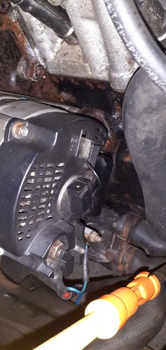

Is my alternator wired correctly
Discussion in '8-valve' started by Mk2 driver 1800, Oct 15, 2021.
  1. Mk2 driver 1800 New Member
    Jun 2, 2020
    nope, the blue wire needs to move to the stud closer to the big red one, it should be labelled D+
    the stud its on now is to hold a P clip which supports the alternator wiring
