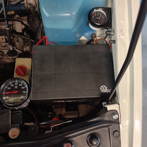

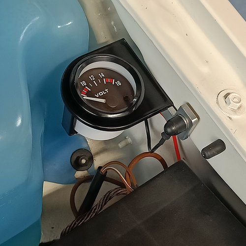

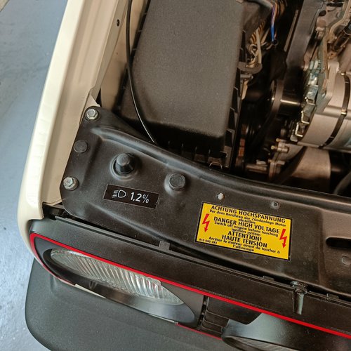

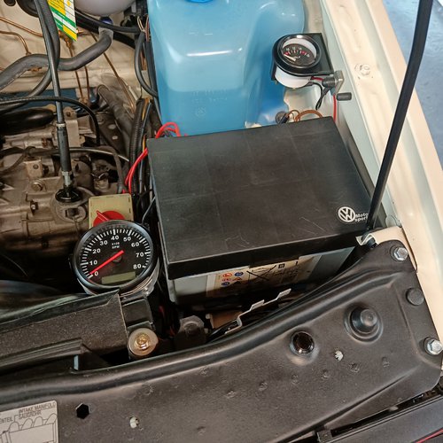

  8. Zender Z20
    Nov 28, 2021
    631

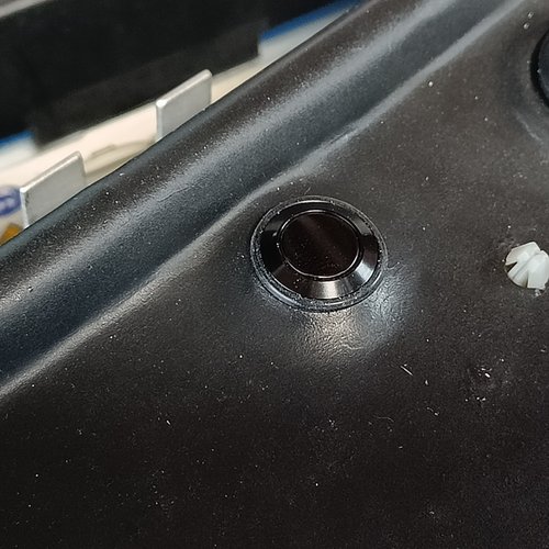

    This was done in the same vein as fitting the tacho. under the bonnet (helps doing the CO on the Gunson)... this time it solves the irritation of having to go get the keys / start the car to check the interior gauge or hoke out the multimeter instead, now I just have to press a button if I'm passing.
    Yes, the cars are on battery conditioners over the winter, but in between times that's not always the case.
    No new holes etc., and only existing fixings used (think they're for the PAS bottle on Diesels / G60's?), the vacant slam panel one that's beside the bonnet buffer was handily the exact diameter to take an off the shelf sized momentary button.
    The contours of the washer bottle (again to allow for the G60 bottle?) I think lends itself to something being there.
    Bracket's the shape it is to keep everything below the bonnet line / fouling when it's shut.
    Button is fused on the battery side, so nothing's live 'till it's pressed / off again when released.

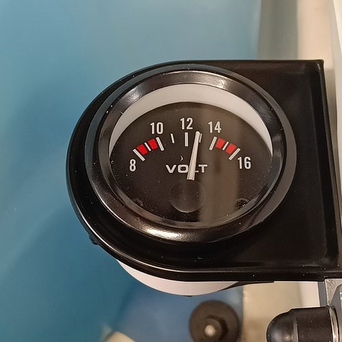

    Gauge is a cheapy, didn't want to risk a VDO, but don't see it getting too much abuse where it is all the same.
    Checked its various readings against the multimeter and it's exactly spot on.
  9. caddyboet
    caddyboet Paid Member Paid Member
    Jun 11, 2011
    303
    Durham
    What battery cover is that? Looks like a nice fit for the smaller batteries.
  10. Zender Z20
    Nov 28, 2021
    631
    That is the larger of the 2x recommended battery sizes for the MK2, sits out over the lip of the chassis leg... I inherited the cover years ago with the MK1.
    Part number is 281 915 411F, date marked 1985.
    The battery beneath it in the image is a UK code 075 (L.242mm / H.175mm / W.175mm), cover's a mm or so outside of that so as to clip over it.
    The smaller recommended battery option is UK code 063 (L.207mm / H.175mm / W.175mm), the cover might still snap on widthwise, but it'll have a 35mm overhang lengthwise.
    Edit: Looks like UK code 012 fits the MK2 also - L.207mm / H.190mm / W.175mm, but again not long enough for this particular cover.
    (Those are VARTA L/H/W measurements - others may vary slightly)

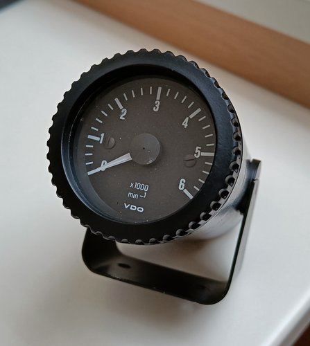

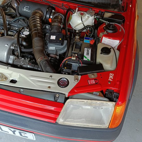

  20. Zender Z20
    Nov 28, 2021
    631

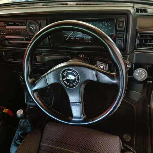

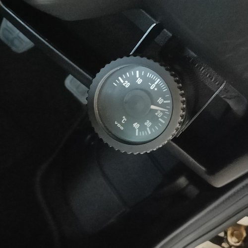

    Originally had the outside temperature gauge wired in from the get go along with all the others, but some days it worked, and some days it didn't.
    Since the car was finally back on the road and running faultlessly, didn't want to tempt fate and risk delving under the dash upsetting anything, so let it slide.
    Picking up a rev. counter from the same VDO range recently and it got me looking at the temperamental ambient gauge again.
    Turned out it was the sender body had a weak earth, the bracket's intended to do that, but mustn't have been up to the job.
    Booster wire later and working perfectly, even matches the MFA's reading.
    The rev. counter'll be for the MK1's engine bay, in the same way that the MK2 has it's own when using the Gunson.
    Runs off the coil or the 'W' spade on an alternator, temporarily had it running off the MK2's.
    There's a little screw that allows you to trim it to match the engine.
    Strictly speaking it's probably a diesel tacho as it only goes up to 6K, but since I want it for doing the CO it's immaterial.
