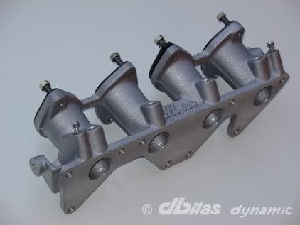

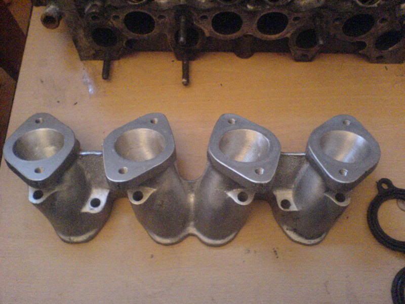

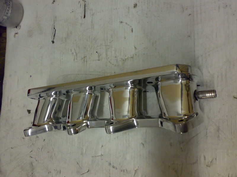

Here's a couple of 16v ITB Manifolds . Thought i would start a thread with the range of types and manufacture to help anybody. Dbilas Pro Alloy I have DTH so not required , but found these when i was deciding what to go for. Please post any you have.

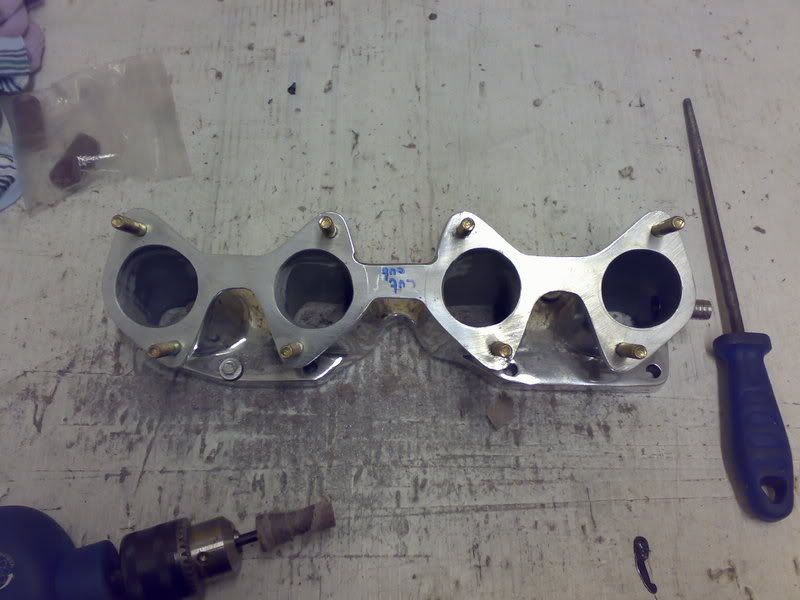

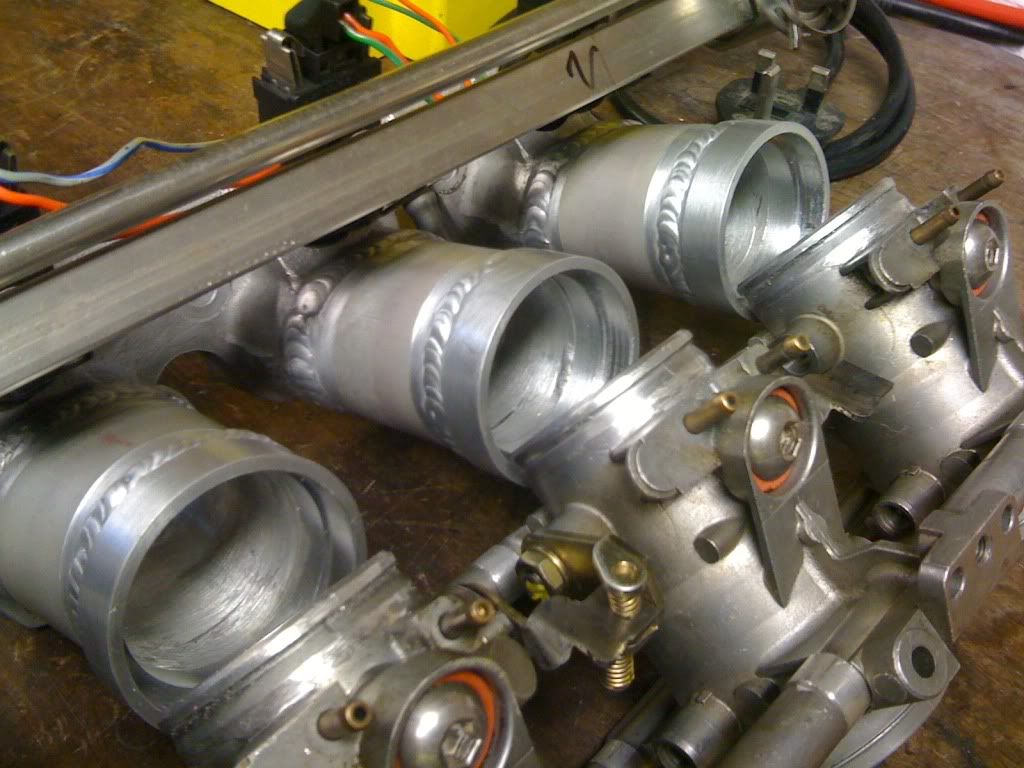

Did you do the tig welding mate? If so what tungsten / filler sizes did you use? Thanks! Just started messing with my TIG lots of practice needed!

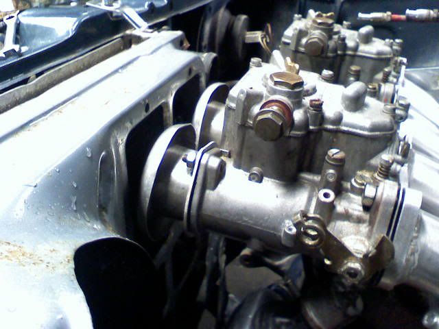

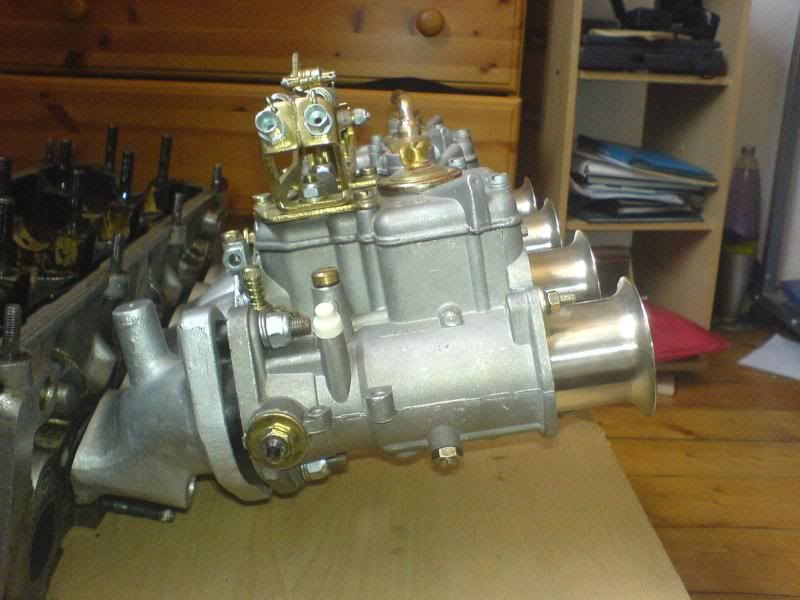

JMR dcoe style... to suit dcoe type bodies as well as carbs... Needs to be fitted with this tho... And a low radiator is needed... And there's plenty of clearance to the front panel (with a low rad)...

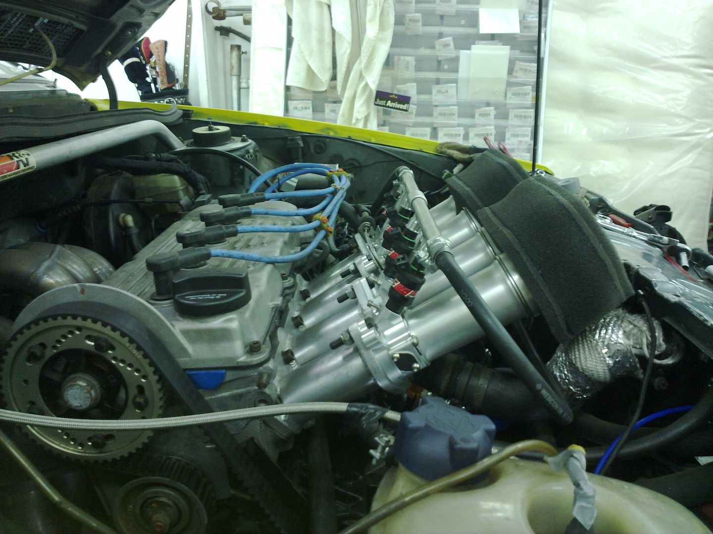

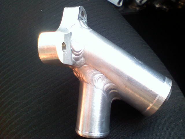

Used a Rowland one on mine – I think it was the MO62 (long) on the website http://www.manifolds.co.za/?page_id=41 Needed a bit of work to it – like opening out the ports to suit the bigger carbs and some port matching – also middle brace removed to clear linkage – also used a swan neck water outlet from pierce manifolds usa

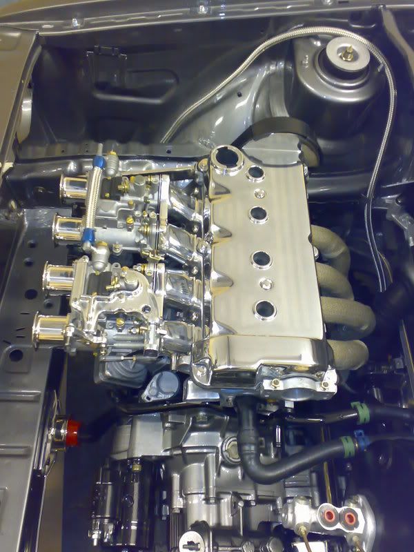

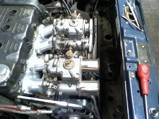

possibly the fastest grass in town, that setups got to be worth an extra 25 blade horse power at least!!!
But the grass would be shredded due to needing to rev the nuts off it And yes Danny... who made the 8V crossflow one? And why is the Cam Cover on the wrong way around?
