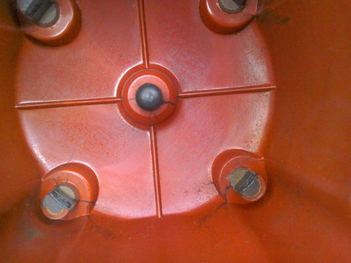

    Ok cheers changed the cap (good used spare) as all burnt and showing signs of tracking inside still cuts out but will now restart straight away.just ordered cap,arm and lead set (beru) all the stuff on there is cheap stuff I suppose you get what you pay for. 1557509121184877834309.jpg
  4. Tristan
    Yeah that cap is shot.
