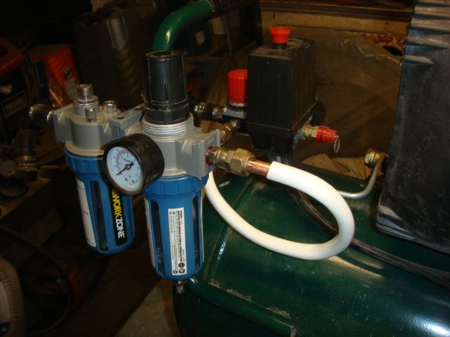

    The filter/lube is from Aldi. Again I could not get the correct 10mm pipe to 1/2" BSP thread so I had to modify the fittings by brazing 2 together with silver solder. Pipe fitting drilled out and BSP fitting filed down to fit the drilling.
