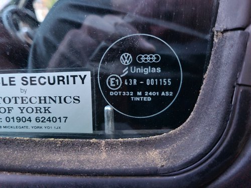

    After having my passenger door in bits today I've found that the metal support bonded to my door glass is rotten.
    Looking for replacements I can't seem to work out what Tints the glass has, were they a standard tint or does it vary by manufacturer?.
    I have Uniglas units fitted, can't seem to find one to replace it with, seen a few Splintex ones though?.
    The car is a Mk2 GTI 16v, 1989 if it makes any difference.
    Looking at my glass, I can't see a green tint to it?.

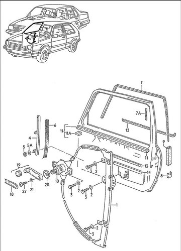

    I've found a full kit on ebay, item 175829895121, 2 door lifters and 2 rubber seals.
    I thought the lifters were bonded to the glass, saved me a lot of hassle that that aren't!.

    Looks clear to my eye but I found the way to tell is to wet the glass.
    I didnt realise my mk2 had a random green tint door glass fitted when everything else was clear, until it rained and the tint really showed! Replaced it now tho.

    yeah they're just press fit, carefully lever/tap off the old ones and swap another good nick one over. carefully squish the replacements on, no need to go too mad held in mainly with gravity and friction from the rubber
