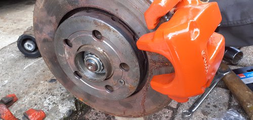

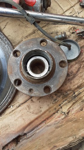

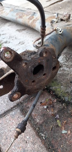

    Got another question on the brakes, After getting hold of an ibiza rear beam yesterday, stripping it and trial fitting other calipers and discs. Pleased with the outcome, now boxed for future use, but in discussions about putting the 1.8t in the mk2.
    The 1.6 has drums, and not got a brake proportion valve or inline, and no brackets that I can see to fit on the beam.
    So if I fitted rear discs, presumably I'd need some type of valve (no abs so easier for stub axles too)
    Any idea what to grab them off, Inline ones probably easiest, I'm sure I've seen them on a master cylinder, but cant remember what on.
    My old caddy van i used polo discs but it had beam mounted valve that had to be shortened with axle flip and had no problem with brake balance.

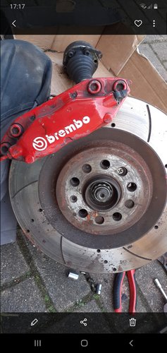

    Here's some pics, Leon Cupra R setup on ibiza/polo hubs and stubs, just need the lupo gti style backplate to bolt to golf.

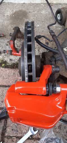

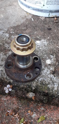

  6. dodgy
    Got fronts too, nicely on vr6 hubs

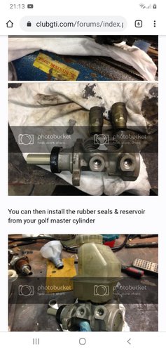

    Knew I'd seen reduction valve somewhere recently,
    Stubby focus master cylinder thread, 2 birds, one stone eh?
    they're fitted to post-84 cab/rocco, possibly 1.4 mk3 golf and you can have them from other cars too.
    before you go that route check the rear lines carefully, if theres any signs of rot may as well plumb in the proper valve same time you're re-doing the rear lines. in particular get the heat shield off often rusts behind there where you cant see
