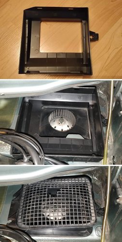

    mk2 golf and seat toledo are the only direct fit options, mk3/4 are too big and odd angles to go in nicely plus need to mod the car to get it secured as mentioned. there are all kinds of various audi which look like they may may go but they're all a bit awkward in shape.
    theres a guy on facebook doing copies of the original mk2 housing, and also special RHD versions which fit nice under the scuttle tray. the LHD ones are a little bit too tall and often hit the scuttle tray especially if you have the later hard plastic type

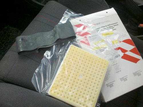

    there was a votex add on filter which was basically, a massive rubber band which you used to secure a panel filter on top of the original housing. I got hold of one a while back but still cant decide if I want to fit it...

    I have the same one. Its from a Chery Amulet which is based on the A2 platform. I got a guy in Russia to buy it for me from the Chery dealer a few years ago and ship it over. For an "Original Part" it is crap, warped and badly fitting. But it does fit. I binned the filter that came with it and fitted a MAHLE LA19 which is flat rather than curved. It doesn't fit quite right on RHD because of the rail tray shape being wrong. I think the hard plastic rain tray's would fit better.
    If I was to buy one again, I'd ask RD plastics about it. They're Ukrainian and their parts look excellent. Its showing as Sold out at the minute.
