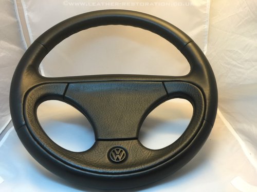

    heres a genuine leather wheel:

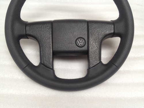

    vs non-leather with a decent trim job (ignore the obvious aftermarket textured section, look at the joins to the spokes):

    Thanks gents, the pics you kindly posted illustrate the issue I was wondering about, I'm really keen to get the look of the factory wheel (no step up in thickness from the inside of the spoke to the outside of the spoke) but in alcantara.

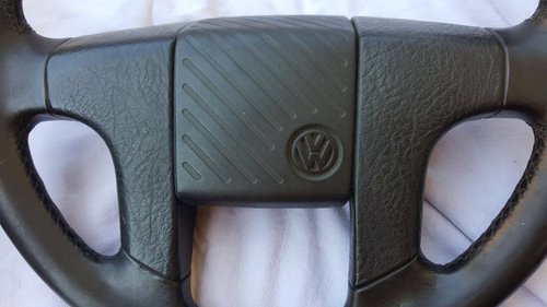

    Slightly OT but the diagonal pattern on the horn push, I always had it in my mind that this was unique to the 16V and G60 but not sure that is correct? I had a 1989 8 valve gti in my teens and that had the plain horn push
    its an age thing, the diagonal pattern type 191419669K is listed up to 89 then they switched to 191419669G smooth type according to ETKA. If you look at the 90 G60 brochure it still has the diagonal pattern push on there so its definitely not trim specific :)

    Thanks again, that’s interesting to know. I prefer the plain one

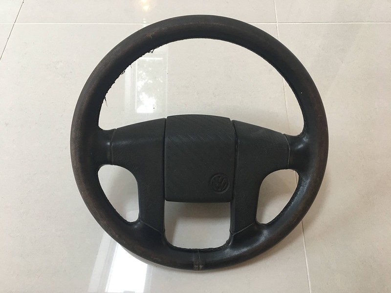

    Well they say 3rd times a charm, after returning the previous 2 wheels this one popped up in Latvia, was a good price so decided to take a chance as the seller assured me it was solid. Arrived this morning and first impressions are very good, very dirty but ideal for what I want to do with it.
