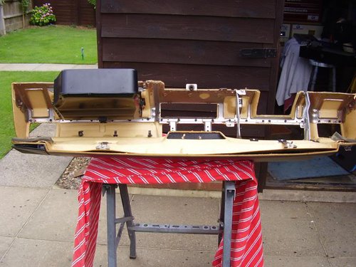

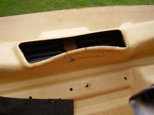

    heres some pics that explain the cause , the dash is made from some cardboard type stuff and the screen duct had come away , the intake was also deformed by someone shoving the radio in with lots of wires behind it [:$]
    the fix is to use some polyureathane sealer like tiger seal to caulk into the gap , then clamp it tight over night until its set
    refit the dash and you should have working demisters ( while the dash is out you might like to fit a new matrix )

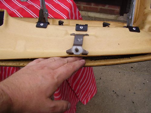

    spot the fault ? it should be bonded tight all the way along

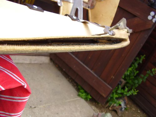

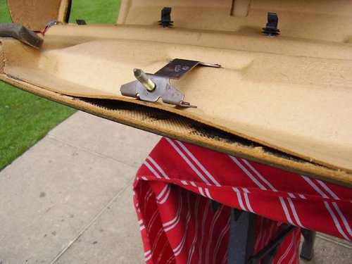

    couple of closer pics where the 2 parts have split open

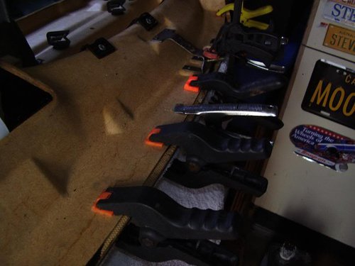

    all glued up and waiting to set , i used polyureathane sealer that sets over night , use some wood and old rags to stop the clamps marking the dash, put some thought into what you use so you dont reset the dash too straight
