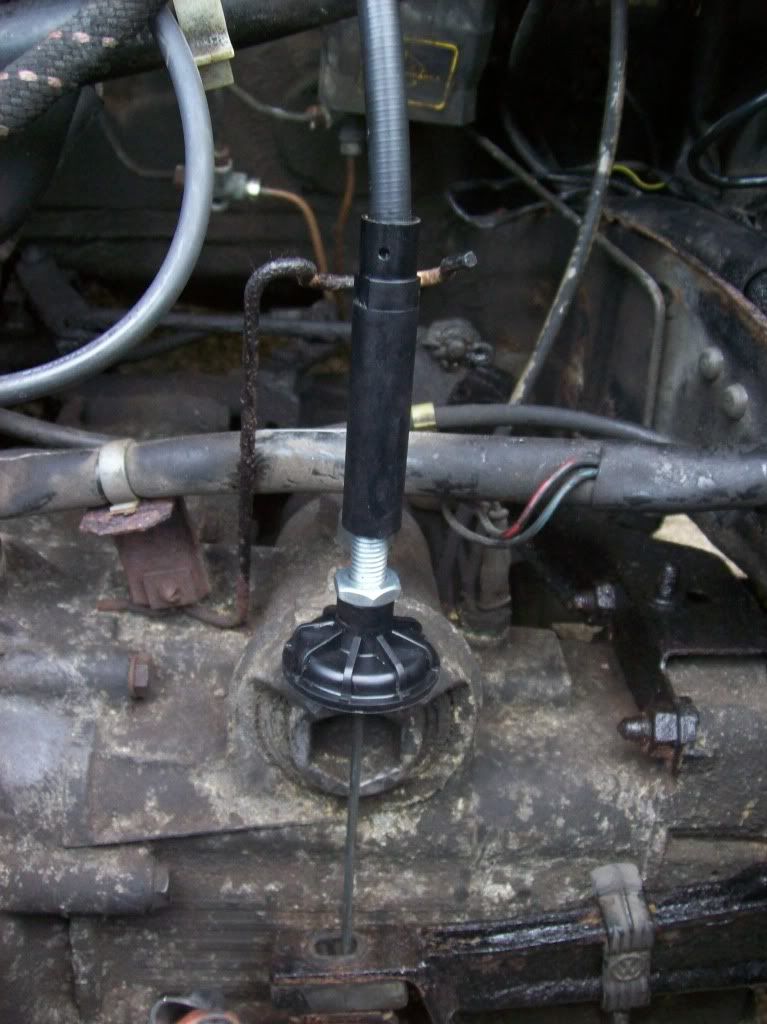

(21) 192721335G clutch cable rhd - 192721335G KUPPL.ZUG 25.7 Euro Rotate the knurled section @ 21 until you get 15 - 20mm free play in pedal VW dealer

I usually get mine from GSF and I ask them to give the manual one. I have never needed part numbers for it. as for fitting, It will fit the same way as the old one so just take note when removing, only fiddly bit is releasing the sliders under the clutch arm. to adjust it you will see a 15 or 16mm nut on the cable by the gearbox end, just loosen the nut and spin the big round plastic thing under the nut (the round plastic bit that sits on the gearbox). I can't remember which way round is to get the bitting point higher or lower but a few attempts will get you sorted. you might need to loosen the big plastic bit all the way when fitting the cable as its alot easier, then adjust accordingly.

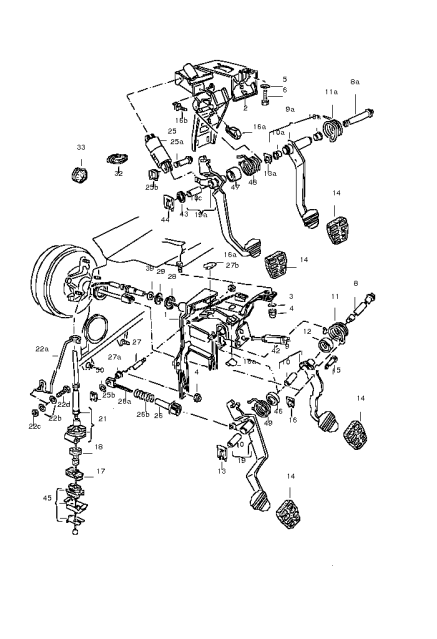

The clutch and brake pedal should be the same height, If the clutch pedal is higher then the plastic stop is either missing or fallen off the clutch pedal stop (locaed under the steering column somewhere)

Really?! I didnt know this, I just thought that was how it was meant to be, mine is a fair chunk higher than the brake pedal - I've just gotten used to it over the last few years! Does anyone know exactly where to look for this plastic stop? Can I get a new one from GSF or is it a VW part only? Can I assume that once Ive fitted a new stop, I will have to re-adjust the clutch cable itself?
hey mate, instead of buying the part which btw ive spend a good hour trying to find out what had snapped and iam still non th wiser. if you take the lower dash off (few screws) and have a look at where the clutch pedal rests there should be a hole, i made a new stop from a nut and bolt and a few washer (you may need to play about with washer sized to get the right pedal height) and jobs a good'n i would really recommend a manual cable thou! cheers.
Cheers Cope, I might have a lookee under the dash then, the tray under the wheel is removable then? (I think it was from when I installed my manual choke there, hmmm) Luckily, cos I've got a 'top spec' driver, I already have a manual clutch cable!! Oh to have a clutch pedal thats the same height as my brake... the dream is nearly there!!

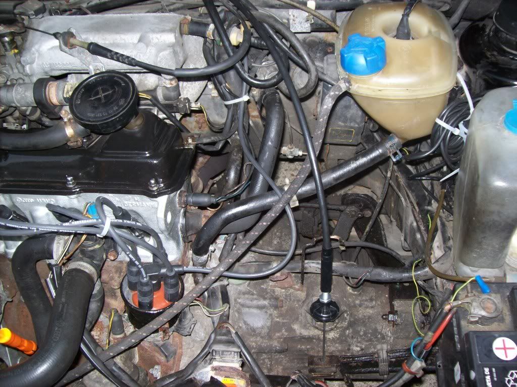

looks liek you're missing the rubber cable mount bush on the box, it sits under where the black bit is and has like a rubber tube that the cable pushes thru
agree with rubjonny, the big round plastic bit on the cable that sits against the gearbox should have a rubber washer type bit under it. the rubber washer centralises the cable so it doesnt rub against the gearbox. I cant see it in the pic The plastic stop is a pain to find and is VAG only I think. makes a big difference not having your foot permanently in the up position lol
You mean Cope is missing the rubber tubey thing or me!? I think I must just be missing the plastic stop on my pedal..?!
ahh thanks for clearing that up guys! ive found the rubber boot/stop think on my old cable so i will do a quick transfer today! cheers.
