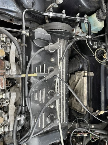

    So some progress, have now polished the whole car looks ok considering what the paint was like have done 3 stages and a wax using Mirka products Polarshine 10, 5 and Nanowax before this gave it a clay bar, iron remover and glue and tar remover.
    Took the seats out and hoovered the carpet not sure what to do with the seats will try to get some reasonable matching front ones as I can’t see retiming them being cost effective.
    Following the recommendation on here spoke to Northampton Motorsport about a tune and carb setup, but they are booked until June which in one was proves their credibility but does not help me, but managed to get a mobile car tuner out to take a look some positives there was an air leak from the pipe that would go to the brake servo so blanked that off, the coil was wired wrong way round so corrected that, carbs setup the best they can but comment was they are possibly worm, but main problem is timing is ok static but not advancing so I need to look at that as it’s still controlled by the ECU from the PB engine even though it’s now a 9A engine with carbs, have got a timing light to work through that, but biggest problem is it’s not running properly on cylinders 1&2 little difference if HT leads unplugged thought is it’s valves as there is spark and fuel so may have to take head off to investigate, but timing is first thing to sort. The result of poor running is unburnt fuel so exhaust gases as high and need sorting before MOT.
    Any tips on the timing appreciated, I am sure there is a head removal thread but looks straightforward and will line up timing before doing anything.
    ok so first thing strip the pb ecu out and bin it. get a kr ecu and loom, drop it in there then it should run a fair bit better. ideally you want proper mappable ignition but that could wait

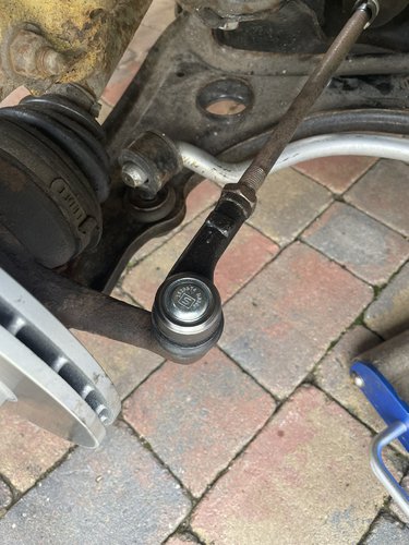

    So took the car for a MOT today to get an idea of what is wrong and prioritise getting it sorted. Apart from the running issues already discussed the fails where around the brake servo not being connected (I did not know this was a MOT requirement it just means the brakes need a lot of pressure). I have the pipes and there is a connection on the inlet manifold so I will look to get that connected up although it looks tricky to get the connection on the servo... Couple of front track rod ends which should be easy and OS outer CV boot which I have read the guide for so will get ordered and the side indicator decided not to work although it did when I checked all the lights so hopefully simple.
    Will remove one of the track rod ends to make sure I get the right ones or are Euro Car Parts generally ok for that sort of thing?

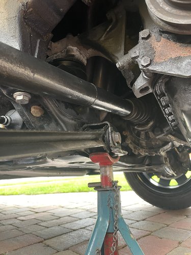

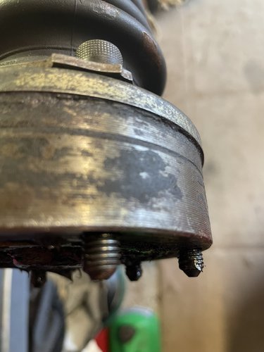

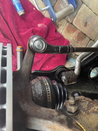

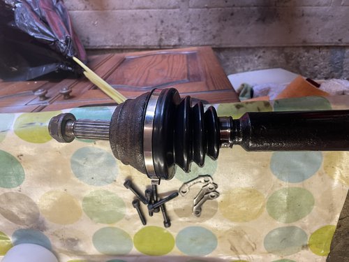

    A few bits done to get it through the MOT - 2 new track rod ends. New driveshaft outer CV boot, as recommended off the car much easier - if I do more will get some of the proper pliers for the boot clamps. The 6 driveshaft flange bolts did not look like they go very far into the gearbox flange - assume this is normal, gave the shaft a coat of paint. Also managed to use the pipes that came with the car to connect the inlet manifold to the servo luckily the pipe out the servo was there and cut off so I could connect to it, although with the manifold it only gets vacuum from 1 cylinder assume this will not matter? Side repeater sorted, just the running issues to get through the emissions and we could be there.

  13. PhilRyder
    Those bolts don’t look long enough do they? Do they go all the way through the flange?
  14. pstarkey Paid Member Paid Member
    Mar 10, 2024
    57
    Buckingham
    Was difficiult to see on the gearbox end - but I will check, they torqued to 45Nm ok, certainly something to keep an eye on.
    PhilRyder likes this.

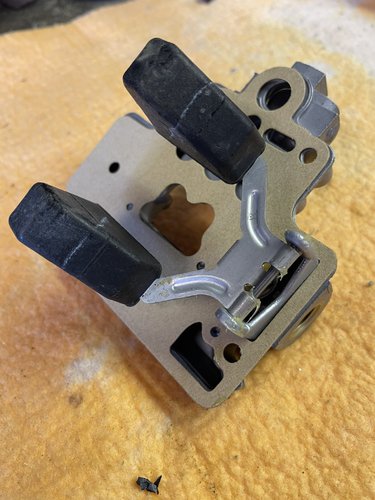

    Bit of an update, as mentioned in the engine thread I found one of the legs that support the float in the carburettor was broken, I needed to get this sorted as see if it was the cause of the poor running. It took a few weeks to get the top part of the carb repaired, but apparently its common for these to break and Eurocarb offer a repair service, so with that fixed new gaskets and everything back together the car runs a lot better, still not perfect, but it passed the MOT emissions so with the other bits I sorted the car now has a MOT.
    In the meantime I have done a number of other jobs, changed the fuel gauge so this now works, cleaned the interior and exterior plastics new gearknob and gaiter, changed the gearbox oil.

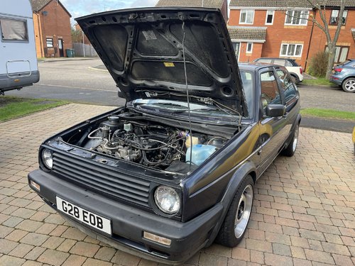

    Bit of an update, as per my updates on the running issues in another thread the car is now running ok and drivable – I can’t see the car ever ran on the carbs as they were as the chokes, idle and main jets as well as the air correctors were unmatched and just wrong for a 2L 16V engine thanks for the words of advice on here and some articles I would on the internet, rolling road is next, this has taken a fair bit of time to sort.
    New fuel gauge fitted as this was not working, managed to get a set of BBS RAs so these are fitted together with a 4 light grill and original orange indicators and side repeaters. Gave it another oil change to keep everything fresh and will change the gearbox oil again as it was horrible and ran some more clean brake fluid through following the original full flush.
    Next, I need to get the bodywork sorted specifically the rust around the wiper blank in the scuttle and off side rear wheel arch, as well as general scabbing underneath. Driving the car, it feels good stops well, steering feels a bit light, but I may not be used to it. Gearbox seems to have no synchro on 2nd, 3rd or 4th so looks like I need it rebuilt or a replacement 2Y box.
