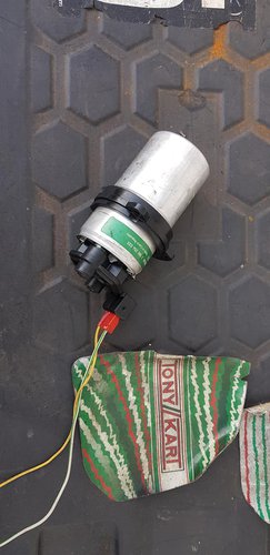

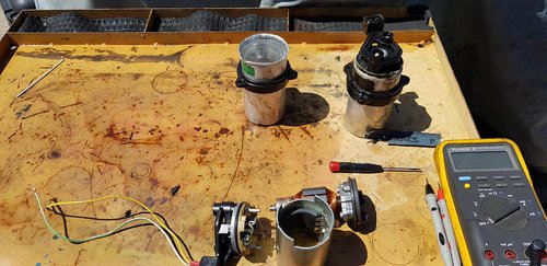

    The lift pump works and is pumping. The main pump underneath isn't and I don't have a spare here I only have a Bosch 044 inline.
    I hate that parts places aren't open during the weekend :(
    Edit: I checked with the multimeter and it's getting battery volts. The pump itself has continuity but I'm not sure what else to check to make sure it's actually dud and not just stuck a little

    Could be worth putting 12v to it and giving it a few tap with a rubber mallet
    try reversing the voltage also, but I would say its probably had it and wants replacing. maybe bin the lot and go mk3 tank, probably cheaper and easier than trying to get the parts to rebuild the mk2 pump unless you get lucky

    Yeah so I replaced the pump and the new pump works however I am not getting fuel to the rail still. I put some carb cleaner in and it fired up but obviously won't idle. So I know I have spark.
