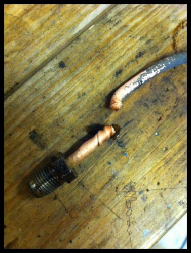

    Well, 40,000 miles had taken its toll as a daily runner. Ongoing repairs in that 40k included :

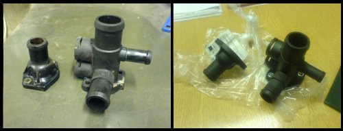

    • Coolant housing (for top hose and coolant temp sensors) cracked.
    • New Radiator.
    • Oil breather split on top of cam cover giving a lumpy idle.

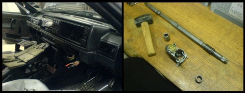

    • Ignition switch which caused a breakdown would not start. No 12v live to ACC circuit. That was a pig you have to have to drift the steering column apart to get the switch out!
    • Park brake cables corroded, full of water and partially seized. Park brake would jam on with frosty mornings.
    • A battery.
    • Two centre silencers and a rear silencer.

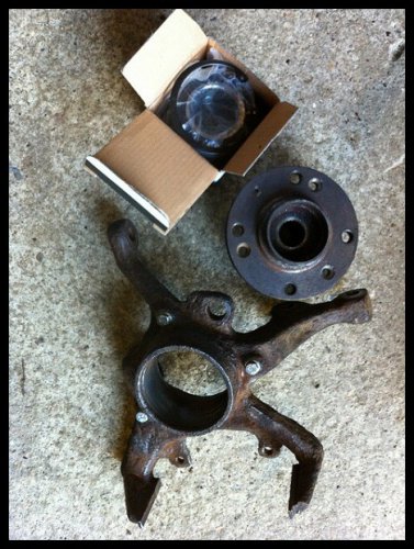

    • Front wheel bearings
    • Drivers door handle snapped.

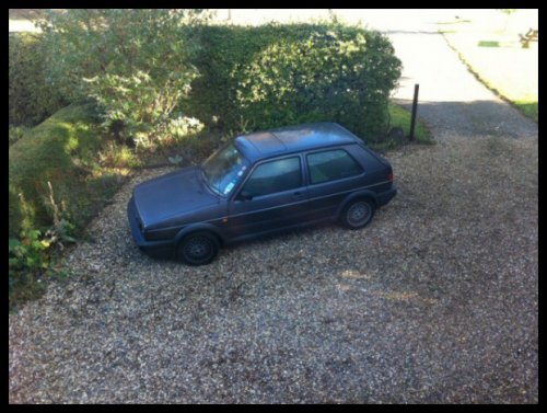

    This February 2012 it sat on my drive looking very sorry for itself still in daily use though. The wheels were black with crusted brake dust and it had a list of faults as long as your arm. I knew it needed an 800 injection of cash (minimum) to bring it back to some sort of glory. The car balanced on a knife edge between being placed on eBay for 850 or returning to VW Action at Pod shining again.
    It was a 50/50 split and in retrospect, I dont know why I put it up for conjecture really. I got 40,000 miles of what is cheap motoring with no depreciation and three door cars need to be saved really. Plus, you really do feel part of a community with the mk2 and every day that passes you get closer to that classic status. Seeing the values of mk1s climbing everyday, I think the mk2 is a keeper really. Doesnt make sense to ever get rid of it.
    Once the girlfriend had been convinced that a dead car on axle stands for two months was a good idea; work started.

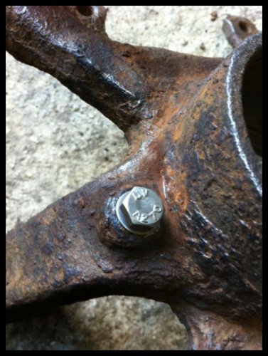

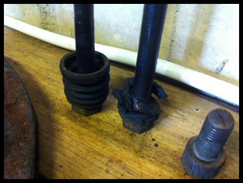

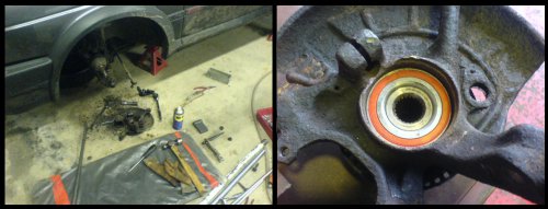

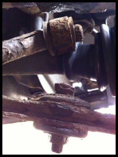

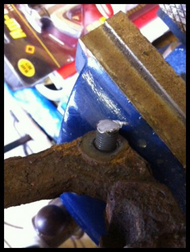

    • Front Suspension
    Broken anti-roll bar drop links and rotten disc backing plates. CV boot split.

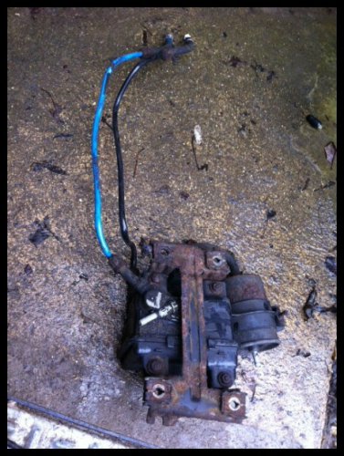

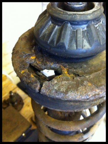

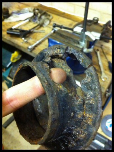

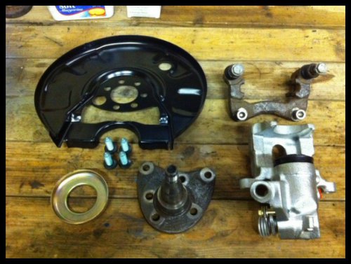

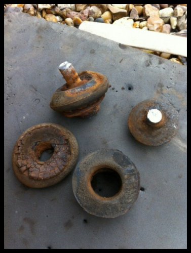

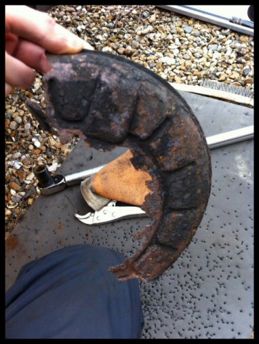

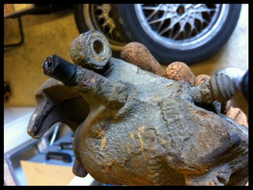

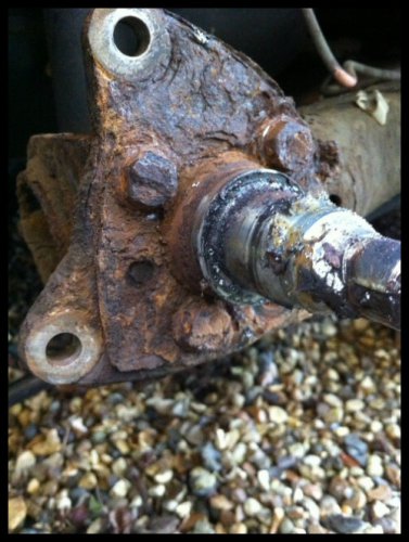

    • Rear Suspension
    Shock absorbers leaking fluid, coil spring top seats corroded real bad. Callipers seized. Brake pad friction material had separated from the pad backing plates due to binding heat. Rotten disc backing plates one had fallen off!!
    Snow stops play! [eek]

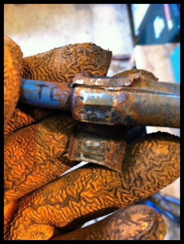

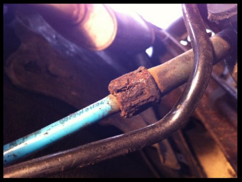

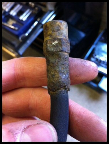

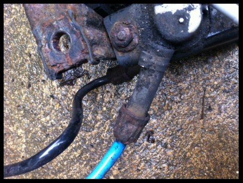

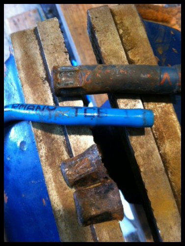

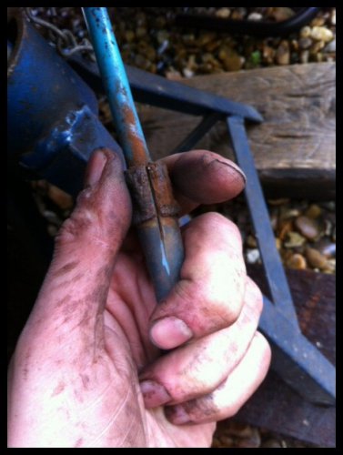

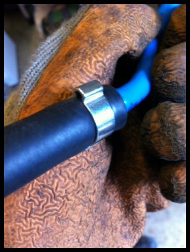

    • Fuel Lines and Pump
    The metal crimp joints that secure the rubber hoses to the nylon hoses looked really bad. Luckily the nylon pipes have brass inserts, which means you can just cut the crimps off an re-crimp. Fuel tank dropped and all fuel pipes sorted.
    Continued...
