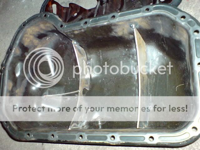

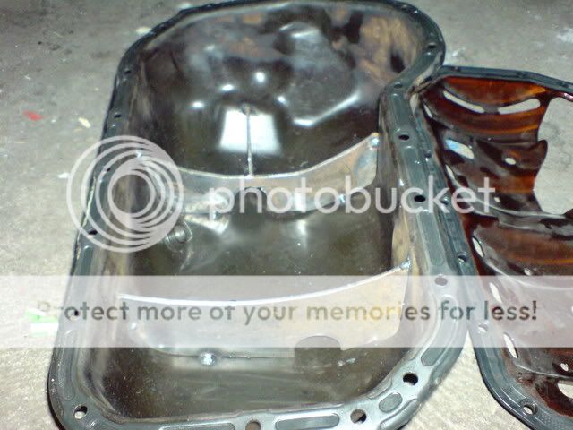

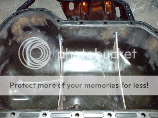

    Thought I'd post a pic of the baffled sump I had made. I originally handed a mate my sump, windage tray and a pic of the schrick sump for him to copy. Although when he got round to cutting plate for realized it would be alot harder than it first looked due to the bowel shape of the std sump.
    I got it back last night, did a quick test fit and it fitted perfectly. :)
    It aint the prettiest sump I've ever seen but should do the job.

  2. Dub20vt Forum Member
    Somerset
    Good effort! liking that.
    it's bound to work to a point aswell!

    I didn't like the idea of fitting the windage tray and leaving out the std small plastic clip on baffle so thought this would help aviod oil starvation.

  5. gillm
    gillm ***** User
    3
    yeovil somerset
    did you make any templates ?

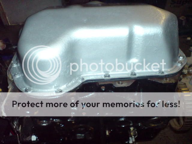

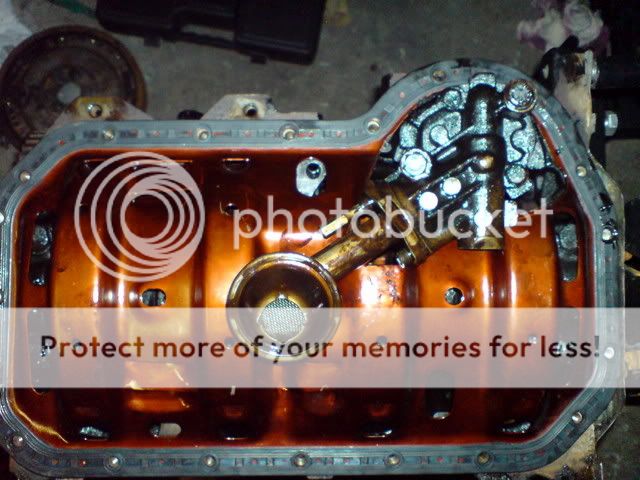

  10. Phil. Forum Junkie
    Mar 12, 2004
    5
    Northern Ireland
    Removed the pump and fitted the windage tray. Also sprayed the sump and fitted it back on using the longer bolts from a deisel engine to allow for the windage tray (part no> 904 234 02).

    Nice - looks quite a bit like mine. Mine is heavily inspired by TSR's.

    Is there enough allowance of space to allow oil out when changing engine oil ^^^
    very nice and shiney though.

  18. Briankl Forum Member
    Nov 10, 2006
    16
    Denmark
    Well, actually the holes were enlarged afterwards since I considered that exact same problem. Also it's possible for the oil to seep under the baffles given enough time and warm/hot oil.
    As for templates: Mine are long gone. I basically just did a couple of mock-ups - but granted, it was a lot easier since I had an empty block where I could mount a pump to. That made it fairly easy to trial fit. However, it would be possible to make with the engine still in the car given enough time and care.

    Phil, please tell me you didn't paint inside the sump?
    Looks like it'll do the job tho!
  20. Phil. Forum Junkie
    Mar 12, 2004
    5
    Northern Ireland
    :lol: no I grinded then sanded the welds and any splatter then washed it out thoroughly then painted the outside only in hammered silver hammerite.
    I'd read a few posts where people were discussing what special type of paint to use for spraying the inside and thought why bother! it's not like it's gonna rust..
