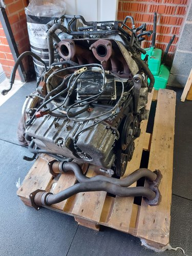

    Bear with me for this one, it's not my car, but I've basically been collecting everything for it, bankrolling parts until payday, and will be fitting and sorting the new drive train, I own an engine hoist and most of the tools. IMG-20200716-WA0000.jpg

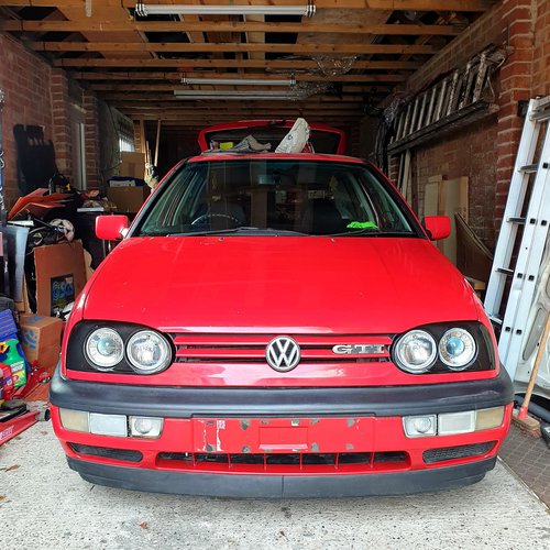

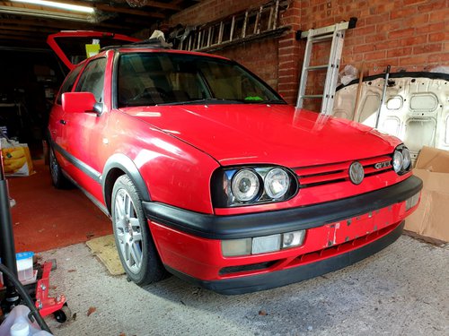

    So, late mk3 Gti in red, anniversary interior and a set of porsche D90s, belongs to my mate.

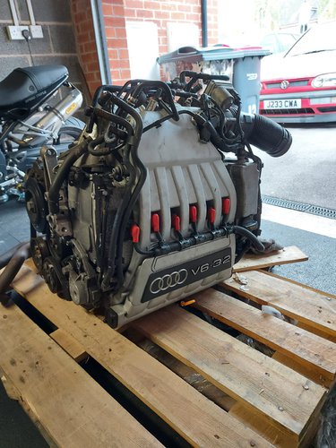

    Acquired an Audi 3.2 v6 engine from @nass on here. I've then sourced a V5 bora gearbox, flywheel, starter, vr6 mounts, 100mm cups, hydraulic clutch system, wiring etc, pedal mount, trackslag downpipe and a load of bits I've forgotten probably.
    There are also a set of tt discs and calipers and my old spacers to mount them, 9n rear hubs etc.
    It's going to be a slow one due to location and work but think it will be a good project.

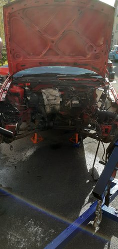

    And so it begins.

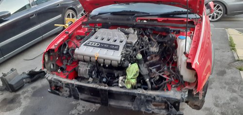

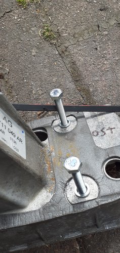

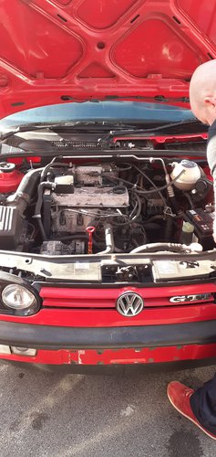

    Day at mates, got the mk3 gti apart and engine out, only problem was the exhaust, 3 cutting discs to chop it enough to break apart at the cat, access is a right pain.
    V6 off the stand and bolted up a v5 flywheel, new vr6 clutch and a 2.3 v5 o2j gearbox with 100mm cups.
    Rear mounts from a vr6 on the engine, mk3 tdi on the gearbox and a modified vr6 front mount, captive nuts removed so bolts can go through to the block/box, packers were required between the top bolt hole and block on the mount, only a couple of washers, whereas I've read people putting 17mm approx in there, perhaps it's a vr6 box they use?
    Engine fitted in car, all mounts line up perfectly, not a bad day's work
    And now some questions,
    Aircon compressor is VERY close to crossmember, could remove it, but the mk3 has air conditioning so would be nice if could keep it, so is there a smaller comp or notch member? Or if remove it any idea of the belt length?

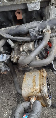

    Next, oil filter/cooler had to be removed to fit mount and looks as if it will have interference when go to refit it, is there an alternative one or mod?
    Thanks, a pooped dodgy Dave.

  12. Mk2daz
    Jun 2, 2015
    Good effort, the engine looks nice in a mk3!
    Could you get a smaller oil filter on? I'm sure theres a certain polo one thats pretty tiny
    Failing that, maybe just relocate the filter elsewhere with a oil filter take off plate bolted to the housing
  13. dodgy
    May look at relocation plate, but kind of recall a 1.8t one being used? Didn't get any pics of it, but it's a cartridge one, not a spin on filter like my s3 lump.
    Used to be use a reliant kitten spin on in tight applications as they were very short.
  14. McPikie New Member
    Nov 17, 2009
    This guy recommended an oil cooler from the 12v 4mo engine I think as it's slimmer so there's room around the mount
    erreesse and dodgy like this.

    Got some time on this yesterday, engine back out, loom out, gearchange out.
    Swapped oil cooler on front of engine to clear mount, and cut the rear mount down so have clearance and it sits better.
    Vr6 thermostat housing bolted up and engine back in for now.

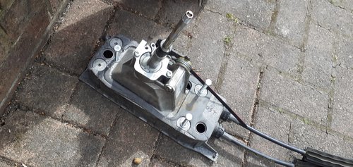

    Front mount is super squishy so have got some bits on order to modify it, worked out the gear change mount so will sort that this week, it's an A3 one and different to the standard mk4 one.
    Clutch master cylinder fitted too, pipes and slave on order along with sai blanking plate.
    So progress but awaiting parts now and loom to be sorted. 20220619_162656.jpg
    caddyboet and MJA like this.

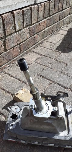

  20. dodgy

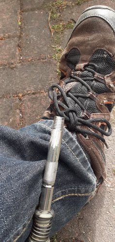

    Early morning mods, audi a3 gearchange unit fitted with m8 nutserts and stick chopped and threaded to take anniversary style gearknob.
