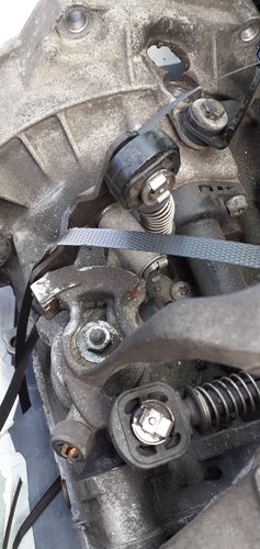

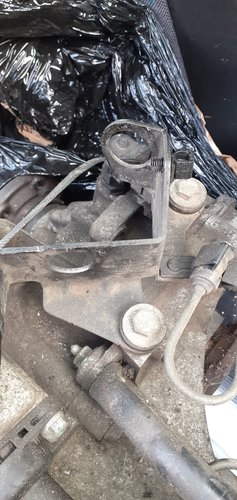

  5. dodgy
    The box just arrived, looks like they left the bracket and ends on, just unscrew them.
    So is it possible to use any golf TT or leon set up, or even my original o2m set if I swap ends?
    Got a g60 flywheel coming and need to order vr6 clutch kit, any specific model on that? 2.8 mk3 presume
    alrighty so you have late-late clippy ends, get it all in and offer up your 02m gearstick and cables, see if it works. if the cables are too short then change them for 5 speed versions they'll fit your gearstick since theyre the same, or complete shifter+cables if you cant get cables on their own.
