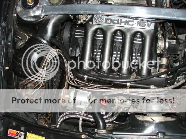

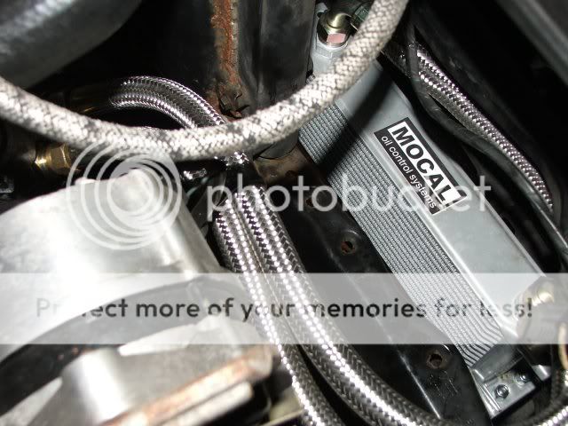

    I've kept the heat exchanger and fitted a Mocal 235mm 13 row cooler with 'stat.
    Car does take longer to warm up than before.
    With the lower gearing ( more revs ) from a 3.89FD my oil temps were much higher before on track, that was my reason for the air/oil cooler, testing it out at Cadwell Saturday. :)

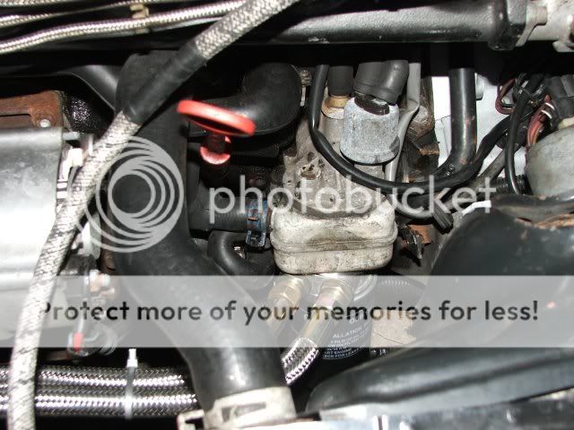

    GVK, How did you fit the sandwich plate?, isn't the threaded tube too short? I thought there were only two tubes available, one for a sandwich plate (mk1 style) and the longer one for the heat exchanger?
    cheers,
    David.
  10. GVK
    GVK Paid Member Paid Member
    693
    Lincs.
    Good question David, can't remember much about that side of it - remember taking the thin nut off the threaded tube to allow the sandwich plate onto the tube, there was a threaded sleeve that fitted inside the sandwich plate supplied with the Mocal kit.[:s]

    Well worth fitting the Mocal, last time out at Cadwell + Snetterton, oil temps were 3/4 way up the gauge after 20 mins. (circa 130-140 degrees if checking on MFA).)
    Yesterday at Cadwell, flat out for 25-30 mins and gauge sat dead halfway (110-115) [:D]
    Gauge reads 25 degs too high, but I've allowed for that.. ;)
