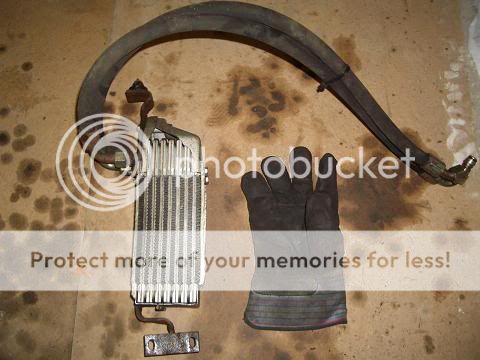

    Would I be best buying a new Mocal oil cooler or similar then or will the one I have suffice? I will post a pic up of it, it's about the same dimensions as the standard fit one from a Mk1 GTI but a bit deeper.

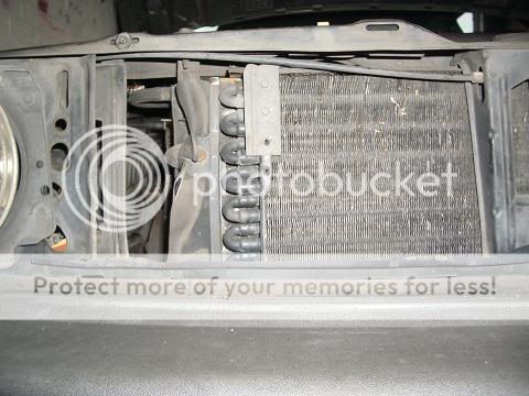

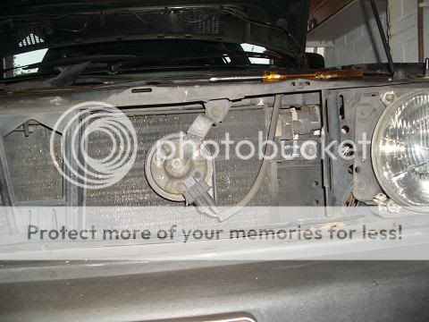

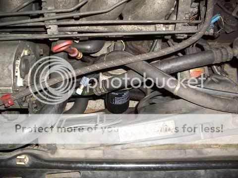

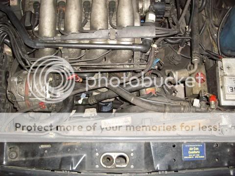

    Been out in the garage this evening to have a look at the possibilities of mouting an oil cooler on my car, doesn't look to handy really due to A/C bits. There is very little room anywhere!
    The only place I can see you could squeeze a small oil cooler is in front of the radiator on the passenger side at headlight level but getting the plumbing to it would be difficult plus it would block air flow to A/C condensor and radiator. [:$]
    I took a few pics - any ideas much appreciated :)
    Engine bay - note A/C pipes and larger radiator restrict space quite a lot!
    View with front grille removed
    The oil cooler I have, looks similar to a Mk1 GTI one but doesn't look like I have any space to mount it!

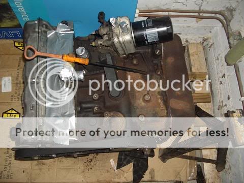

    The 6a with standard heat exchanger type oil cooler, looks like I might have to stick with that for space reasons? [:$]

    Stu, I reckon not only is yr oil cooler in question but maybe the rad too.
    Folks run a lot more power than yours with a 16v standard set up & are fine & a few track folks dont even use an external air/oil cooler- just the standard water/oil jobbie & are fine
    My engine runs a lot lot hotter than a normal 180-200bhp 2.0l does but with all my cooling mods & even driven utter flat out on track with up to 30 deg C ambient my oil temps just nudge into the 90degC area- highest I saw on 'ring trip after 3 continuous flat out laps in that heat was 92degC ;)

    Ps- move ya horn out the way, it all helps the airflow!

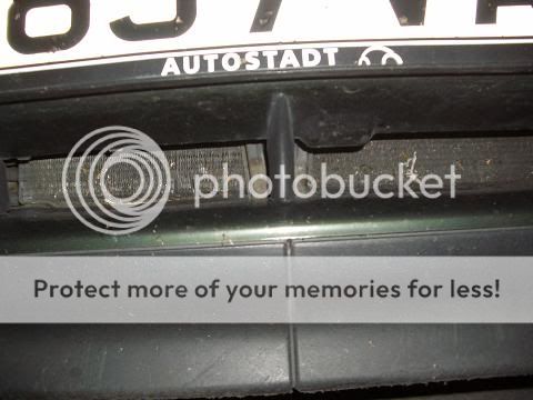

    Sounds good Gary - looking at that link to Tris' pics, do you think it'd be worth putting some mesh/grille wire type stuff in front of the cooler in the bumper? Looks like it could get hit by a stone quite easily in that location?

    I wasn't going to bother Stu - It's only going to be a few inches in front of the rad, and we don't worry about stones going through the bumper vents and hitting that ;)
