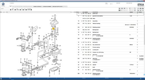

  5. rubjonny
    some if not all of those bits should do, the part numbers they list in the link are for random single bits and bobs rather than for a full kit so its hard to say excatly what models its for. heres a piccy from ETKA, took a guess at 92 year

  6. watercooled Forum Member
    Aug 19, 2012
    170
    Nelson,New Zealand
    Correct RJ I never found a kit when I looked and I wanted genuine parts , I was buying other car parts from the US so bought them from a VW dealer there and combined shipped from my freight forward in Oregon .
    I just studied the PET and picked parts I found were worn on my car ,the parts were cheap and can only presume they were NOS , another visit to their site sometime later and many items were no longer listed and highlighted as discontinued .
    The shifter box is a bit of a fiddle to dismantle but if put together in order it wasn't too bad ,cheers.
