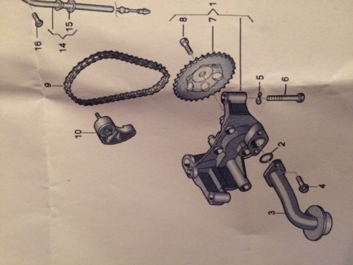

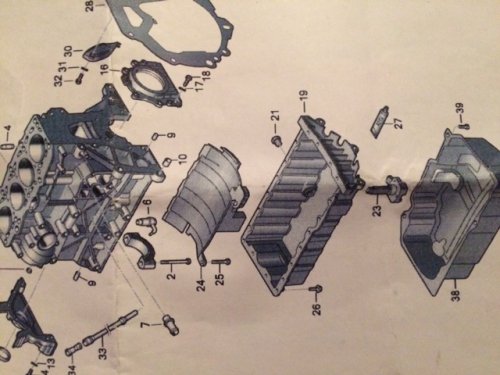

    Think the engine code is BMN, arrangement as below;
    Will pull the sump, as a good clean out is always money in the bank. Not difficult either.
    Thanks again
