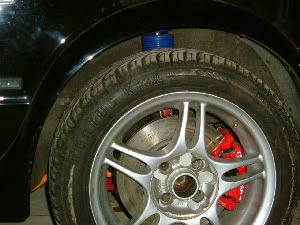

    2009 : New job with more miles and the occasional afghan trip so still kept as a weekend car!! Still managed to upgrade the brakes from g60 280 callipers to some nice Porsche ones.

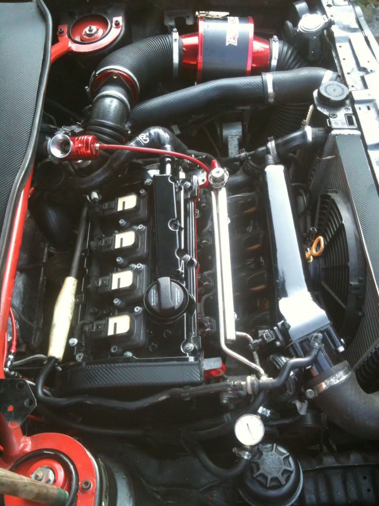

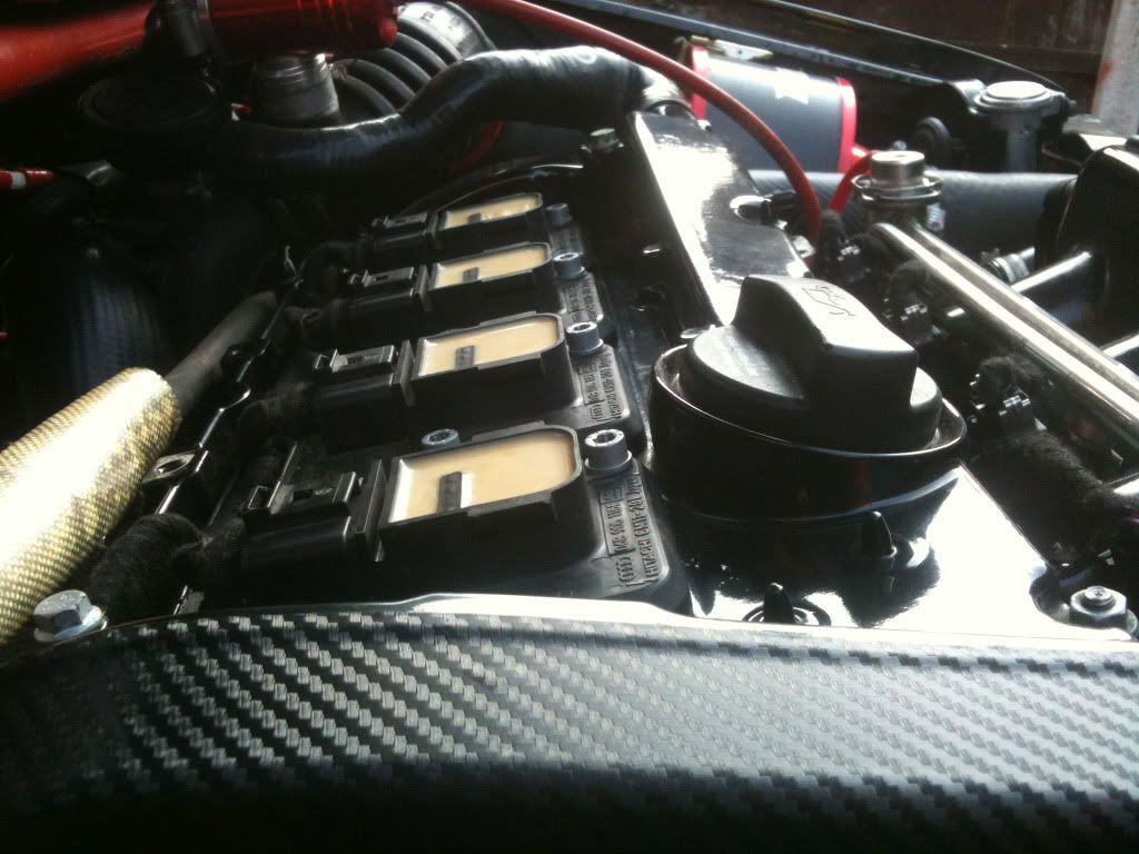

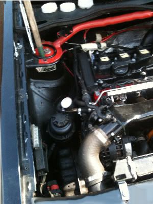

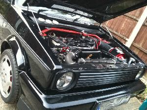

  2. Admin Guest
    nice, i'd like some engine bay pics if you have any?
  3. Willowraf Forum Member
    Jul 4, 2010
    Mansfield
    I'll try and get some at the weekend Jon.[:D]
  4. Admin Guest
    Thanks

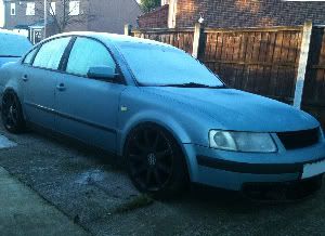

    Also here's my other daily's
    Passat 1.9t
    Polo 1.9t

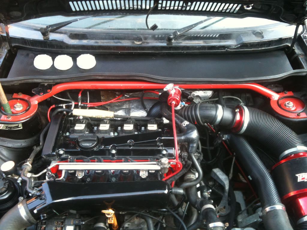

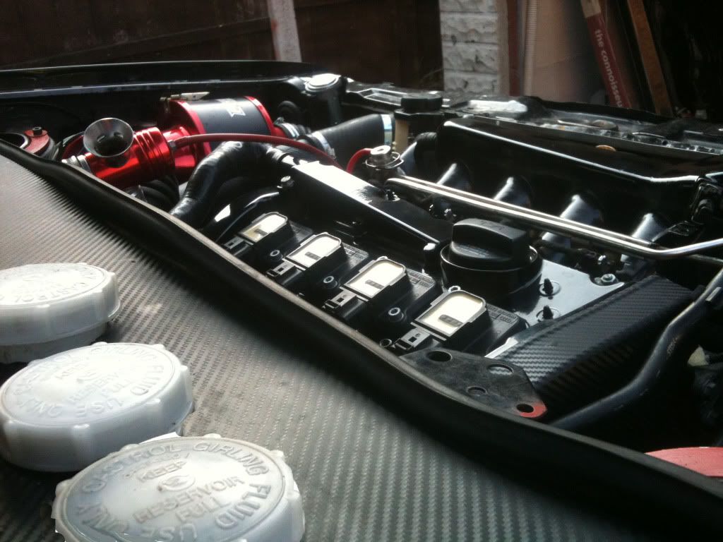

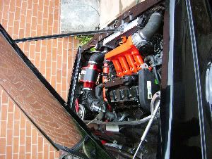

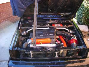

  10. Willowraf Forum Member
    Jul 4, 2010
    Mansfield
    Here you go!!!
  11. Admin Guest
    fantastic thanks!

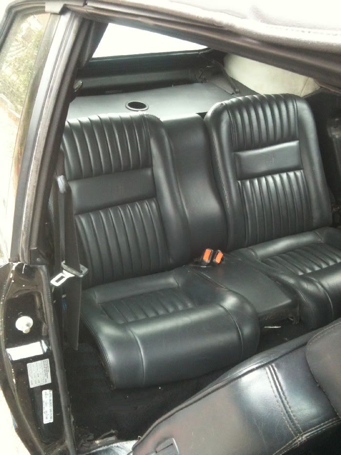

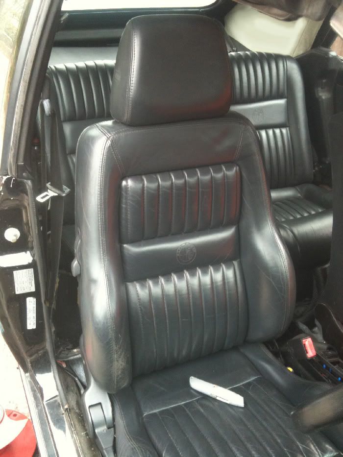

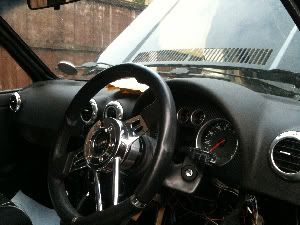

    Right ummm what seats should i fit??? Alfa ATV/Audi tt/ Recaros?? Any ideas or pictures of other Great installs??
  13. Willowraf Forum Member
    Jul 4, 2010
    Mansfield
    Well Alfa GTV momo seats bought in black and cheap... Looking quite easy to fit also. I'll take pictures of fit..
  14. Willowraf Forum Member
    Jul 4, 2010
    Mansfield
    90% fitted just got to tidy up... Really easy to fit compared to the previous mk3 setup..

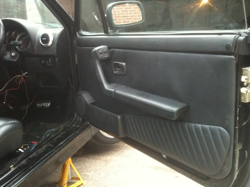

    Some more mods!!! Afla intergrated door cards...
