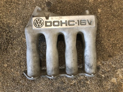

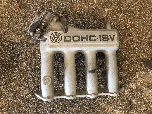

    Im getting confused which inlet is for which type? im seeing a lot of contradictions
    pic 1 is for KR and pic 2 is for PL?

    Could be wrong but I think they're both the same, just that one of them has the throttle body still attached?

    The diameter of the inlet tubes should be different (?) 1 should be larger and the other one smaller

    Ok well the manifold on my 16V KR doesn't have the circular bit on it like picture 2 but it does seem to be the same diameter pipes as picture 2.

    KR should be a 50mm PL 42mm
    Toyotec, KeithMac and erreesse like this.

    It's got wrong manifold on then as Gary says the 16v have the big 50mm runners (necked in the middle to allow spark plug changes).
    I might have 50mm top half available.

    EU CIS-E PL engine has 42 mm runners.
    EU/UK CIS KR engine has 50 mm runners.
    Contradictions come about when folks write ramdon opinions onine without actually measuring parts or referencing the components back to the OE.
