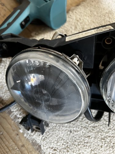

    Hi folks,
    has anyone successfully removed the lens on Hella quads? I want to clean the inside of the lens. I’ve had a little go with a heat gun but so far it doesn’t seem to be freeing it from housing. Is there another way? I don’t want to damage the already fragile quads. IMG_6753.jpeg

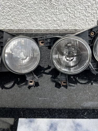

    Wow! I just sprayed some alcohol glass cleaner inside and swilled it about for a minute and they’re clean again! (Left one not done on pic for comparison). Thanks for tips folks, glad I’ve managed to clean them without damaging glass.

    IMG_6787.jpeg I did it. Persistent heat gun on low setting finally freed the original sealant and allowed me to remove glass safely. Gave them a nice clean then refitted using butyl sealant off Amazon (£10.99 for roll). Only time will tell if they’re sealed from moisture exposure.
    I’ve discovered my original twin chamber Hellas are damaged inside now (another thread beckons for repair help)!
