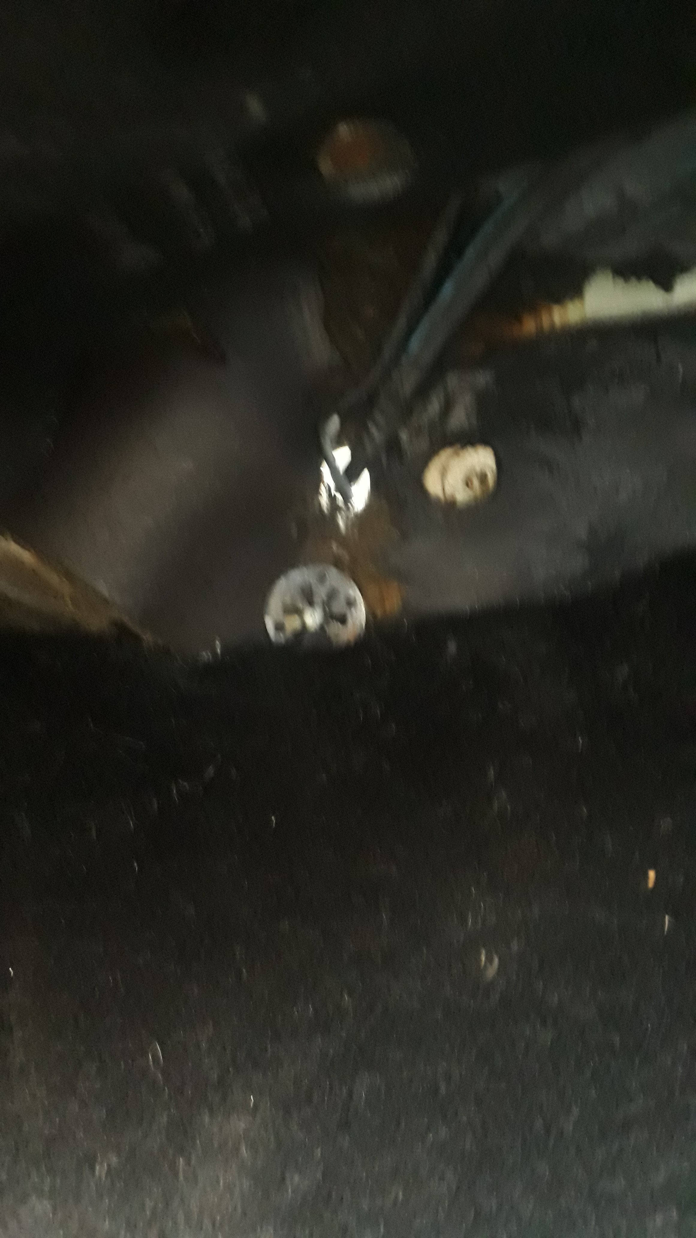

    Is this the hole you're on about Richard? Right of the middle in 1st pic, there's no grommet.
    And from the inside from where I think you're on about:
    EDIT, sorry, I had no idea the photo was that bad until I posted it.
  6. RichardDarrenB Paid Member Paid Member
    Jan 27, 2005
    341
    I'm pretty sure it goes in higher up, under the rain tray from memory. Or maybe not, I'll have a look next time I'm in the garage
    yep the aerial goes through a hole at the back of the scuttle area, then it has to feed through the reinforcement panel on the inside and out of another hole before feeding to the radio. the problem is you're trying to feed it through blind, plus there will be insulation carpet over the top of the hole and god knows what inside the reinforcement :lol:
    you might find it easier to tape the aerial wire to something stiff like a thin long socket extension so you can shove it through then grab on the inside and feed back in.
