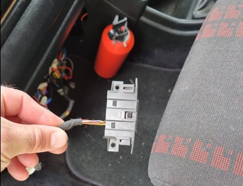

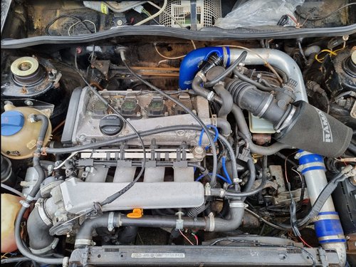

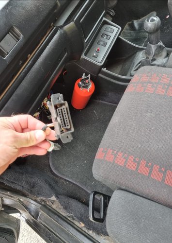

    long story short, friend of mine has bought a 1.8t converted mk1 sportline cab. He has driven it and it was fine, but he has always been aware of untidy wiring near the passenger footwell (i assume it was this side of the car)
    anyway he has attempted to push the wiring up to tidy it up temporarily, trouble is now it wont run at all.
    He has been involved in a very bad motorbike accident and currently isnt in a position to get the car fixed.
    he has managed to send me a few pics and i said i would ask on here on his behalf, hes a very long time, multiple mk1 golf gti owner and he loved his current cab, i think it would be a massive boost if this turns out to be a simple fix . If anyone could possibly help it would be massively appreciated
    i thought the plug looked like something obvious like an engine loom plug but im clueless in the grand scheme of things!
    IMG-20211118-WA0004 IMG-20211118-WA0004.jpg IMG-20211118-WA0002.jpg IMG-20211118-WA0001.jpg
    many thanks indeed, stew
    The plug is a diagnostic connector / EOBD plug.
    It sounds like he's just disturbed a wire or connector when he shoved the wiring.

  4. Tristan
    I Don't know tbh, with that engine, he must have an ECU somewhere, could that be up behind the dash?
  5. rubjonny
    only way to know is get under and take a look, if its a well made loom it'll be an easy fix maybe just an ignition or live spade fallen out of the fusebox spades. if its a poorly made one you might find all kinds of horror once you look
  6. bonus85 Forum Member
    Mar 20, 2007
    9
    Soufamp'on
    I've been there before staring at a mess of wires not knowing where to start!
    Start with the basics
    Firstly - check no fuses have blown. Go get a code reader too and use that OBD port.
    Check any earths aren't loose.
    Are you getting ignition lights on your dash? If not then focus on the ignition switch circuit.
    If you have lights but no starter motor power focus on that circuit
    If you're engine is turning but not firing then take a look at the spark and injection stuff.
    Then I think I'd hunt for loose and unknown connections.
