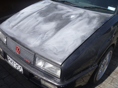

    Really bad clearcoat and very common on many cars in my country,most area's have high sunshine hours and epic levels of UV ,it's interesting it happens on cars much newer than mine.
    Large hand sanding board showed lots of horror and wasn't surprised bonnet has 2 layers of paint ,will update as I go.

    Been looking @ the situation I have here and not having much luck getting the flaking clearcoat off so have upped to more course drylube of 220 grit and that is made a big differance,a bit hard to do as there is nothing flat about a Corrado bonnet so using my Bosch multi-tool which was great on my clearcoat issues with the 87 GTI resto.
    Plan is to remove as much of the top layer without too much "wood graining" which appears to be ok except for some area's where the good clearcoat is like concrete and sticking like "sh%t to a blanket''.
    Clearcoat is feathered off ,not that there was anymore than 10% of the surface,moved to 320 pads and then go to 400,after that I will spray a couple of heavy coats of 1k high build filler primer to see if I get "solvent pop " ???.

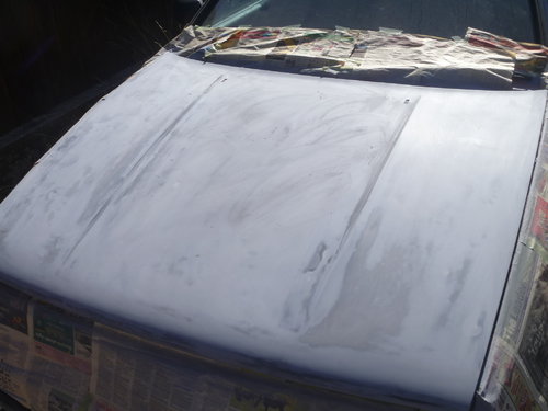

    Well things looked ok after repainting then when I was sanding the clearcoat I got solvent pop from the basecoat,to add insult to injury I had sand thru ,was pissed off but know why and can correct that on the recoat I had a small amount of bad spots so can correct them @ the same time .

    Yes I did think of doing that but instead decided to remove as much of the old paint as mentioned ,got down to the original primer as I removed 2 coats of old paint,the solvent pops were caused by the 1k primer when I touched up the second coat before applying base.

    Got the base layed down well and 2 coats of clear .light sand to get the last 2 wet coats of clear on today if not too windy.
    Yes John that would have been better but already had the paint (VW B7 V ) and besides not a fan of 2k...its nasty stuff tend to stick with 1k cause thats what I know,cheers.

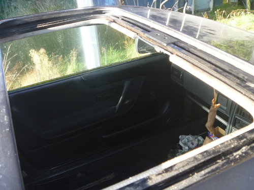

    Moving on to start getting the roof prepped for repaint so sunroof panel out for sanding, the panel still has a reasonably good outer seal which I can mask off and reuse,they are crazy money to buy besides .
    Found out why the roof wouldn't slide back as LH front slider and lock detent both broken ,think I have a remedy for this but spending time understanding working out how it works and then more "why did they do it this way ",the one in my 87 GTI was a much better system but manual.
    Good news is a can confirm the cables are intact by carefully winding it back manually by carefully moving broken parts I got it to retract into the roof.

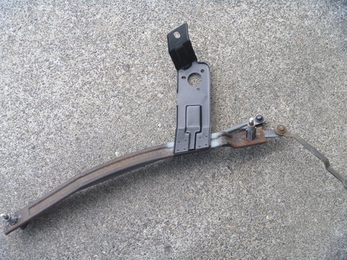

    You would be very much correct on that point, all starts of with the small tab on the chrome ( brass ) locking cam breaking off and instead of the piece locking in the detent it rides over it causing undue strain on the front slider forcing it upwards till this "muck metal'' part snaps.
    The other result is the curved lever which operates the wind deflect raise ups and snaps the top curclip off but this will still work as mine is.
    Not looking good @ the moment due to finding the pivot shaft on the lock is bent upwards ,steel pin pressed into cast piece ...reckon it might break if I try to straighten...will rethink another solution but not looking good unless the lock works spot on ?.

    I do have some spares from a stripped out one from 9 years ago, but not the whole slider. I remember trying to join it together and failing. A company did reproduce these a year or so ago but I believe they all sold out. If you post any pics up i can check what i have.

    Thanks mate, appreciate the interest ,added pic of part ,cheers.

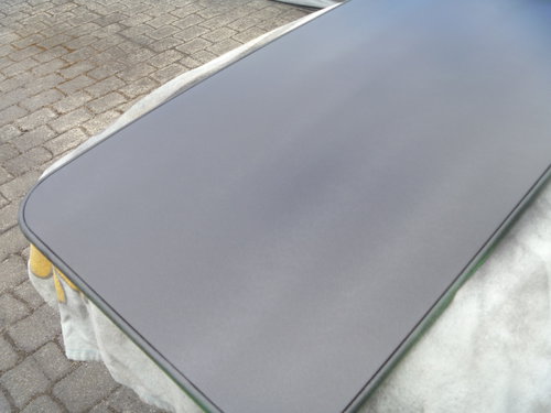

    Got the sunroof panel and sanded the bad clear away then used 2 heavy coats of high build primer ,planned to use some left over mixed basecoat as a guidecoat but not needed so I finished the first coat with what I had...real happy.
    Got the broken lock fixed on the sunroof but put that on the back burner as need to remove the whole cassette because the roof headliner sunroof panels have no lining left..bugger it.
