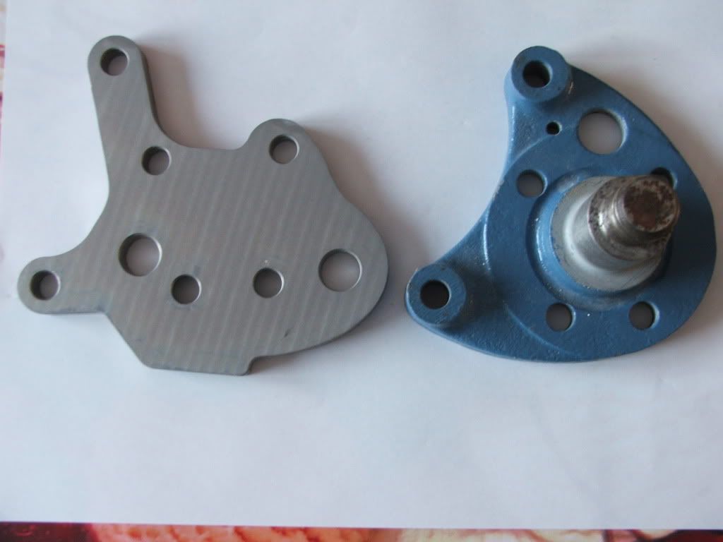

  7. MUSHY 16V
    MUSHY 16V Moderator Moderator
    Jan 26, 2008
    793
    aberdeen
    you get brackets on some of the lupo's that would make good spacers
    they are 9.5mm and the holes even line up
    you may need to trim some of lugs off
    they cost 10 each
    the p/n 6E0501466A and 6E0501465A
    i will try and get a picture up

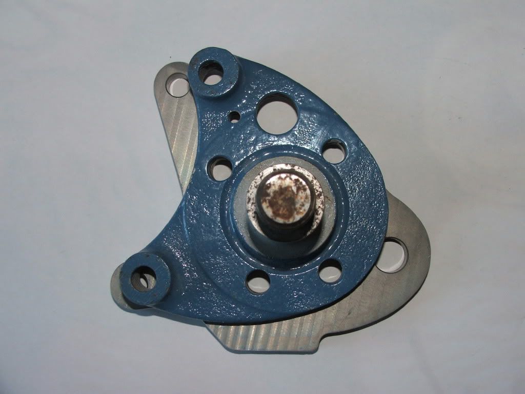

  14. MUSHY 16V
    Jan 26, 2008
    793
    aberdeen
    hear is some pictures of the bracket compared to a polo 6n stub axle
    and yes it will fit a mk3 golf

  18. MUSHY 16V
    Jan 26, 2008
    793
    aberdeen
    yes it for rear caliper to bolt to
    as far as i can see it is only the lupo that has them
    i got them to see if i could bolt 256mm rear brakes off a V5 or 4motion
    on to the mk2/3 beem
    but it has been sat on my desk ever since
    now i have a sticky caliper on the 4motion
    i will try it in the summer i still have to make some spacers up
    it will probably not work but just want to see
