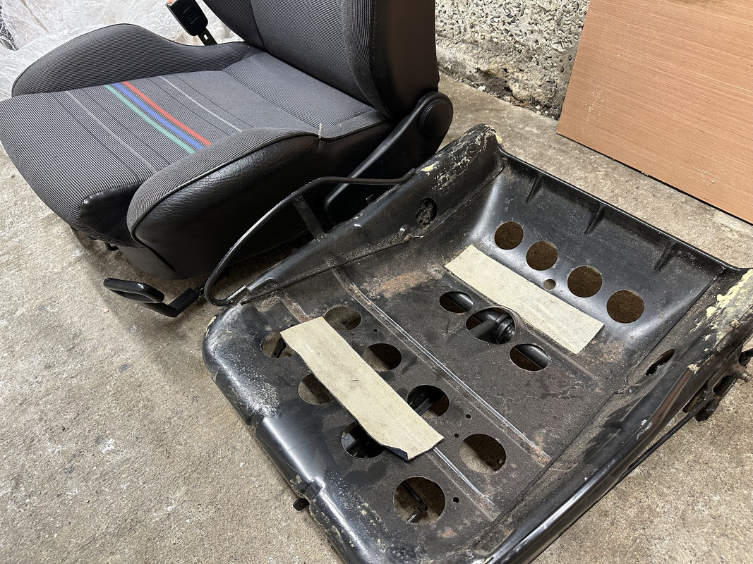

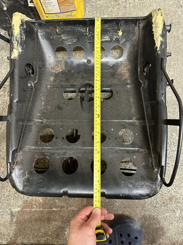

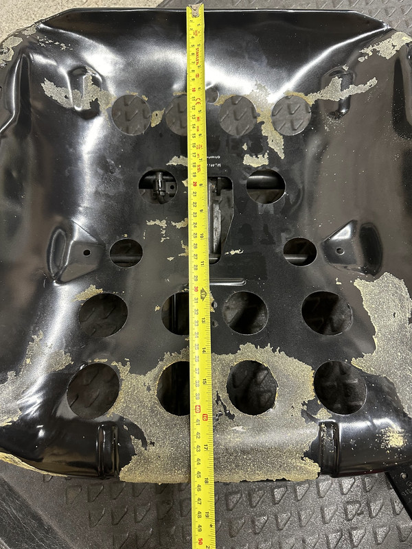

    Anyway, stripped my passenger side seat down this evening to compare.
    Golf Gti seat base
    Corrado seat base
    Things to note,
    The corrado seat is deeper (obviously) but I would say the foam would still sit in snug.
    The corrado seat is longer by a good 8cm, so the foam on the golf seats is too short.
    The early style mk2 golf gti seat bases seem to have the bolster bar built into the foam.
    Like I said, I reckon if the bolster bar was removed from the foam, it would drop in snug, but it would be too short for the base.

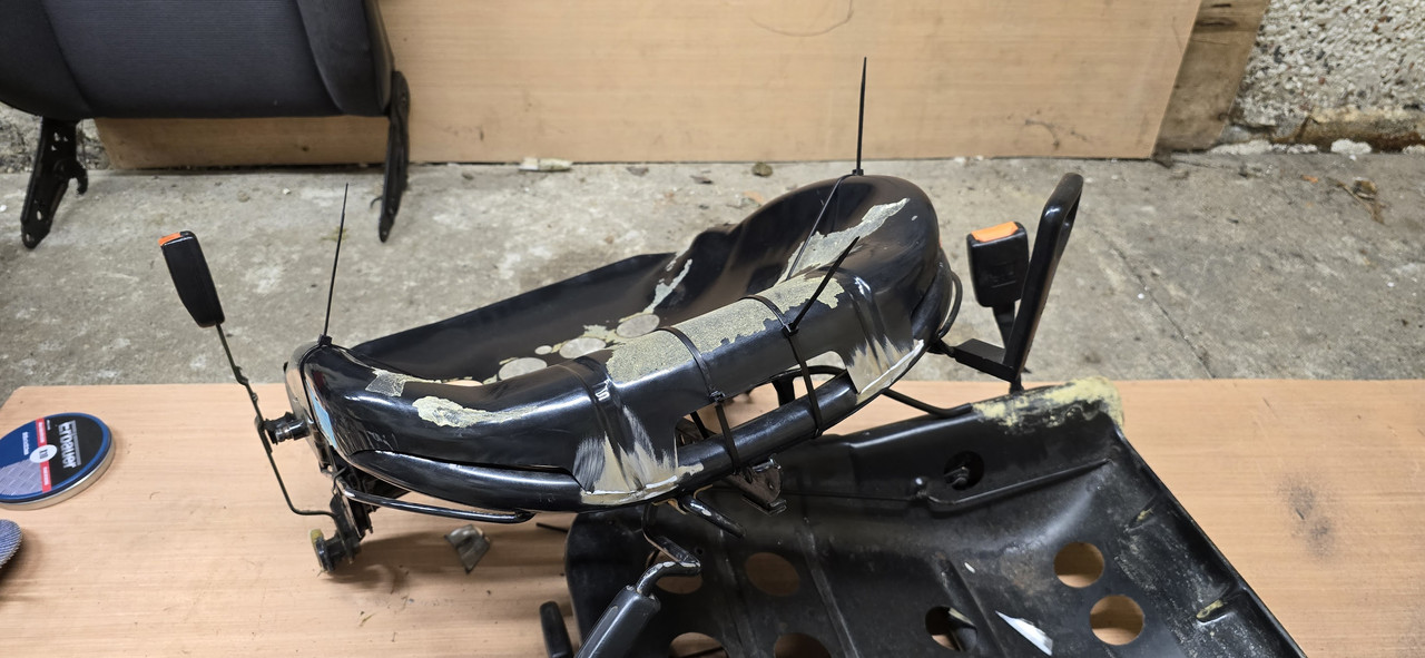

    Ok, so finally onto the seat modifications.

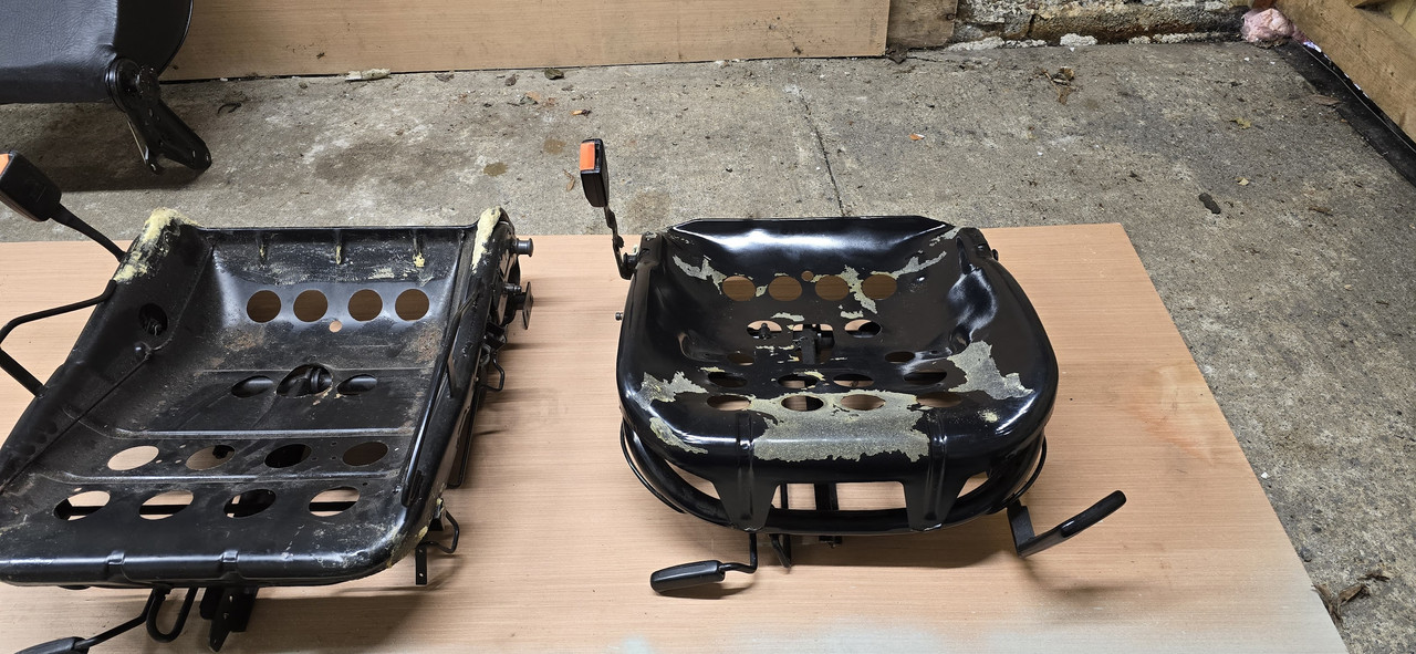

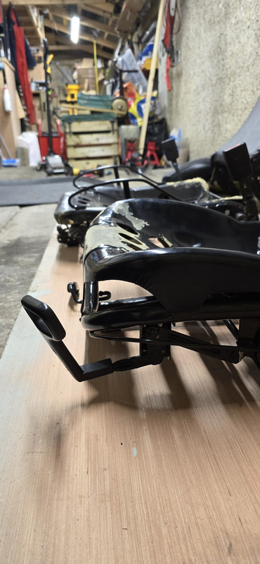

    I had mentioned before that I picked up a set of Corrado seat bases. These sit significantly lower than the mk2 gti seat bases. The internet would lead you to believe that the seat bases are interchangeable, Yes and No.
    The seat backs from the Gti seats do mate up with the Corrado seat bases, but you cannot swap the Gti seat foam and cloth over to the Corrado ones. The Corrado ones have a much longer base.
    I studied both seat bases beside each other for some time, thinking that maybe I could move the seat pan from the Gti base over to the Corrado ones, but again the profile of the seat base just wouldn't suit the Corrado frame at all. Lads must be seriously chopping up the seat frames themselves to get the swap to work, this was not a path I wanted to go down.
    Corrado on the left, Gti on the right. The rear mounts of both seats are aligned in this photo. You can see how much longer the Corrado ones are.

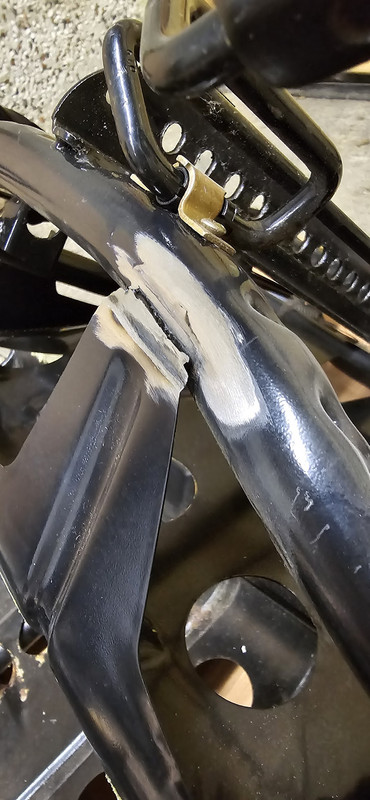

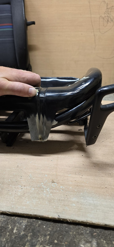

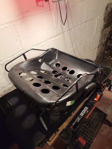

    So what did I do, well on inspection of the Gti seat bases I noted that the front of the seat pan sits very high up off the frame itself.
    There was only one thing for it, chop and weld.

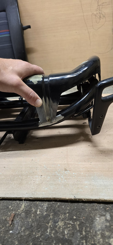

    Original Height
    New lower seat pan height

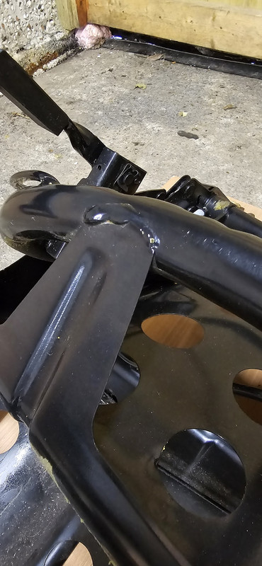

    Ready for welding
    No photos of my welds, well because they are not for the internet.....

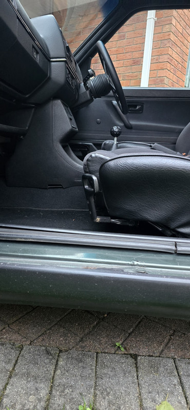

    It's hard to visualise from this photo, but the front of the passenger seat sits at least an inch lower than the driver side now.
    Once I verified that the modification worked well, I repeated it on the driver side.
    The Gti seat bases have rear tilt adjustability, so you can basically raise and lower your Ass, that's it. At it's lowest setting my legs were then being held up by the front of the seat base, which was then making it difficult to conduct the pedals.
    Lowering the front portion has made a massive difference in the seating position for me. I'd like to sit lower in the car still, but it looks like different seats would be required, and I don't really want to change from the factory rainbow interior.
