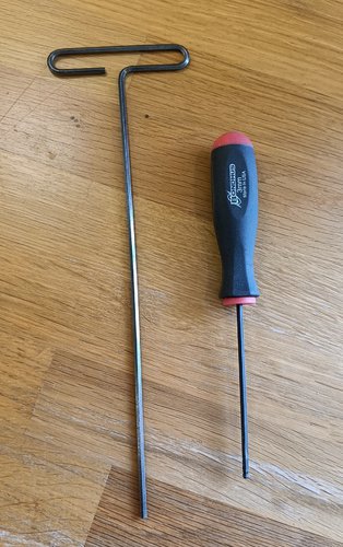

    2. Digifant airflow adjuster... the knurled one is the real deal, the other comes free with Thule roof racks -

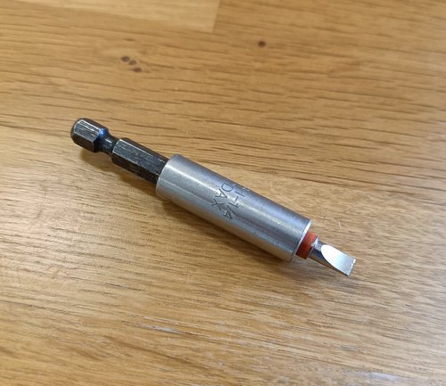

    5. Kjet 3mm air flow sensor adjuster. Again, real deal on the left, with regular 3mm with ball end (much better) driver -

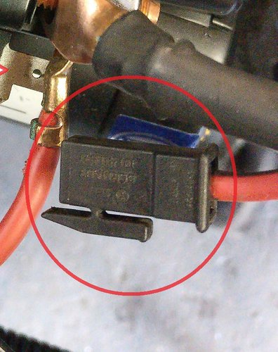

    6. Button top sensor to spade connection adapter (deluxe version with handle) -
    That last piccie's a bad example... it's more for connecting this type of enclosed spade terminal to the button ones -

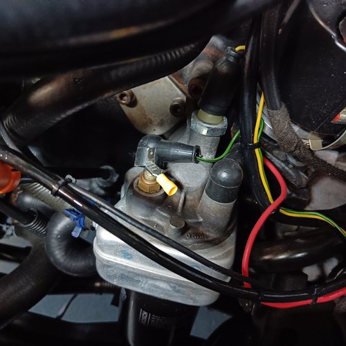

    Forgot the throttle adjustment tool, more for the 205 as it's is well buried down the front of the engine, but also handy for the MK2 -

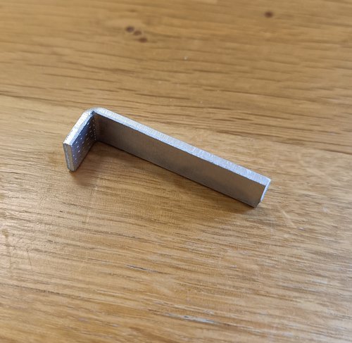

    Not mine, where does this go? Or should I just read the Bentley
  9. Zender Z20
    Nov 28, 2021
    631
    12mm if you believe Bentley, this off cut just happened to be exactly that...

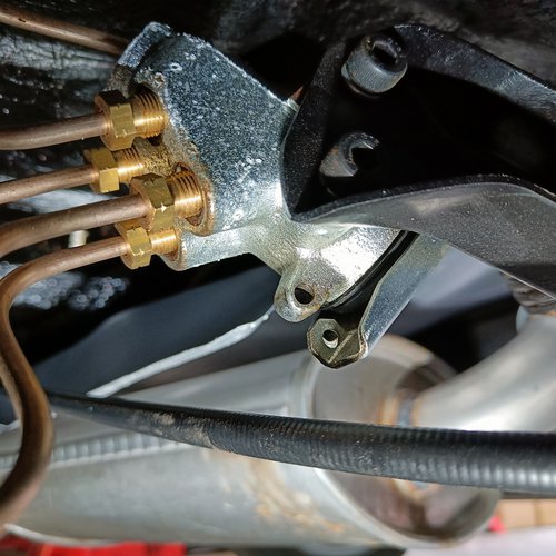

    Brake pressure regulator - fully open position locking stabilisation implement (re-usable eco option)...
