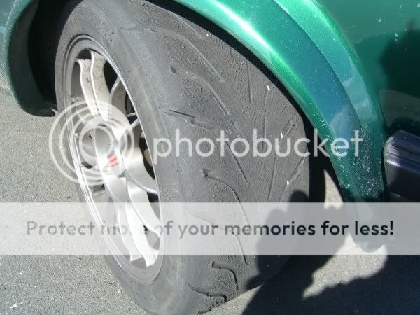

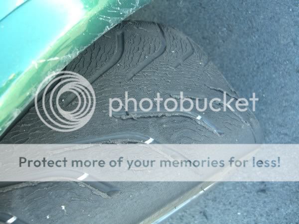

    Hi Guys,
    I just thought that I should mention my error when I bought Toyo R888 SG Super Soft Compound tyres!
    I imagined the SGs to be similar to the Yoko A032r Soft Compounds that I've used before, unfortunately this is not the case! The SG's are super soft, designed for hillclimb or sprints where immediate traction is required i.e there no chance of heating the tyres before your slot.
    As I found, after 3 laps on Anglesey circuit, they begin to over heat and seriously shed the tread quickly! I had to call it a day by 1pm [:^(] But I did have fun up to then [:D]
    Bottom line is, don't buy R888 SG's for trackdays!!! R888's are great, just not the SG's!
    I'm tempted to argue that the Toyo website is not 100% clear on this point, although having spoken to them...... I got nowhere!!

    For reference, the in pics above, the inside edge is worn down beyond the tyre depth warning marker.
