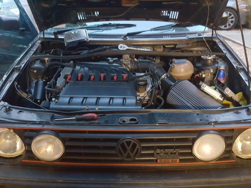

  9. Desertstorm
    Desertstorm Paid Member Paid Member
    Aug 1, 2014
    63
    Toyotec and sparrow like this.

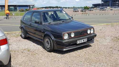

  10. Toyotec
    Looks like you will have another interesting car come Curby on the 28th of May!

    Hopefully be all sorted by then. Not as loud or probably as quick as the A4 but it should go around the twisty bits a bit quicker. Only 275bhp so 100bhp and 250Lb/ft down on the A4 but probably about 500Kg lighter.
