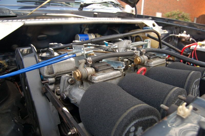

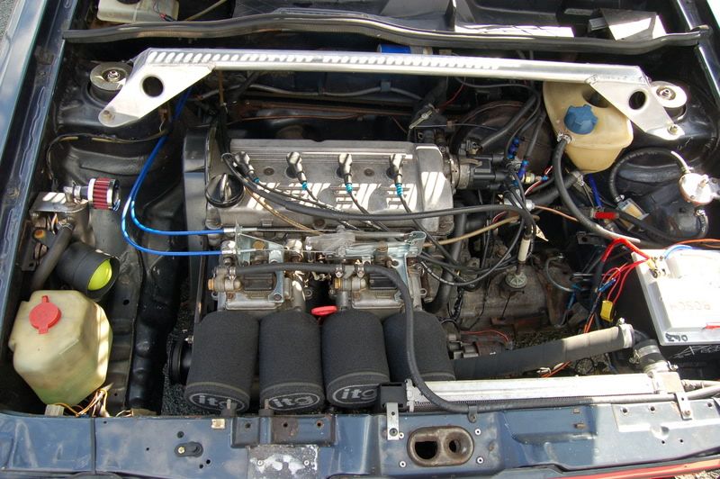

    I was wondering if anyone could supply images of a twin throttle install on a Mk1, mainly at the throttle end if someone can help?
    Presumably for the second cable you need to drill an additional hole right next to where the OE cable passes through?
    Cheers.

    45 DCOE carbs.
    ...with a Weber LP1000 Linkage, it's a single cable kit but the lever mounting plate is the same for the twin cable kit. I'm thinking now to just go with buying two new cables, rather than my butchered up OE Mk2 cable which isn't really working.

    I'll try and get a picture of mine for you in the next day or two.

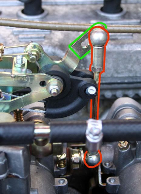

    Right...
    All up and running now! But I've noticed that the throttle pedal (albeit it was a bit too high at first) seems to be a bit of an on/off switch with not a lot of moduluation.
    I was wondering if touching the following would help to increase the travel maybe?
    The link bar (red) is adjustable, longer/shorter and the lever arm (green) can re-position the link bar further in or away from the throttle lever pivot.
    Could someone tell me what adjusting either will do please? :)

    Try moving the piviot back to the hole behind it, or shorten the top link (in red) and move it down the arm (in green).
    Yr cable is also not sat correctly in the end of the quadrant.

    I'll give that a go with the link bar and the arm tomorrow.
    Re: cable. I need to find a pair of cables which have the T-bars at the end, I never got any with my linkage mechanism and it was a single cable kit also. I've now got an extra cable adjuster, just missing the right cables.
