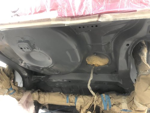

    It's possible to do this on stands but as above it does take an age. Having tried various techniques - scrapers/heatgun, pipe freeze etc, I found the best combo was a variety of twist knot wheels, some tunes and a surplus of colourful language.
    My repaint method was Bare metal > Electrox Zinc Primer > Epoxy Mastic > Seam Seal > Epoxy Mastic > Raptor tinted.
    The factory underseal is a love/hate relationship. It’s probably the reason so many MK2’s still exist but be prepared for what lurks beneath haha ...
    Good luck :thumbup:

    this is perfect! that under body finish is exactly what i would be aiming for, thanks for the info!
