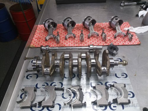

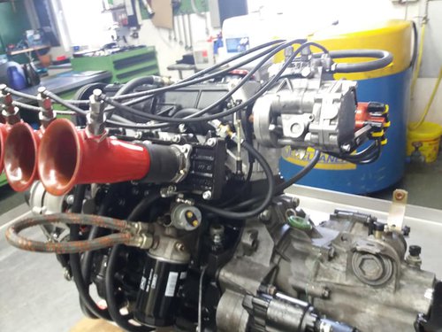

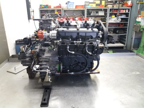

    Photo`s: Martin Baurle and he built this engine...
    Back in the day before the Oettinger and 16V the 1600 8V engines who ran with 41 - 35 mm valves and later with guides set more outward then they could go a pinch bigger
    While the Fiat had 42 - 36 mm valves...so he opted for this solution to run a number years at a competitive level....and now many years later its time to prove a point again.....

    I reckon this Fiat head atleast as good as a VW 8V head with 42/ 35 - 36 mm valves..... as 1600 the norm was 41 /35 mm for a big valve head
    So it wont be short of power potential as it had 42 /36 mm valves ....and its crossflow and allow better porting
    But nowadays a VW 1600 8V can make ca 200 - 210 hp.... not bad numbers....
