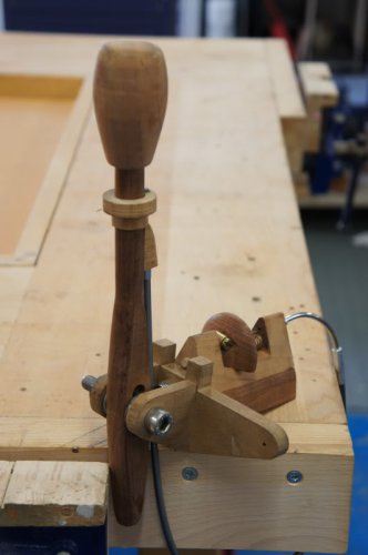

    Similar to a full scale prototype I made a few years ago when I was going to go 02A - im staying 020 so never went any further with it.

    Awesome wood work there mate
    Well done you

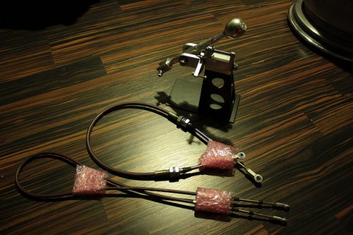

    I have done a lot of work on the cables recently and found they are boat control cable with a modified clamping , there are 2 sizes used 33C for the shift across the box and a 40XL for up and down gears , The shifter i have made is all done and with with stainless bases , just doing test fits and making cable brackets :-) when i have the time
    Bit i am stuck on is trying to find decent cable ends , Telefex do some , but some are discontinued and i an not using the quick release items , they look prone to failure

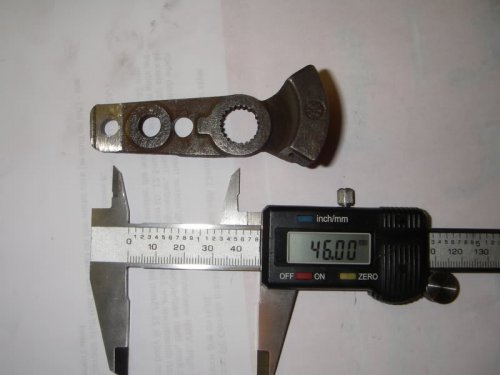

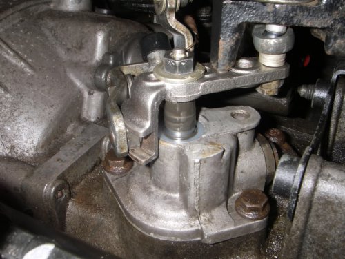

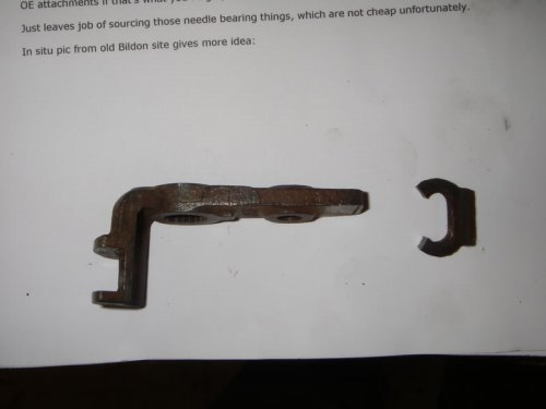

    This is posted on the previous page, a genuine VW Motorsport-supplied part for 02A spec, which is easily replicable with the data I posted. This is what I run, and I'm not looking to run anything else.
    Why throw away the ball ends? Convert back to 02A, and it can be done in situ.

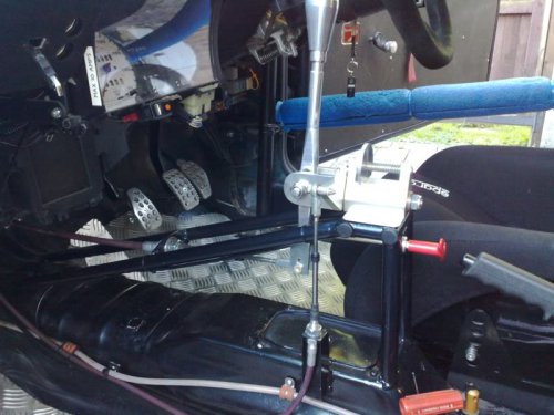

    hey hotgolf how you getting on with your shifter? I have finished drawing mines up in catia and have made a mock up so hopefully over christmas I will get it machined out.
    Did you use cables? I have made mines up with rods but id does require the bulkhead to be drilled and and a new cover for the centre console made up.
