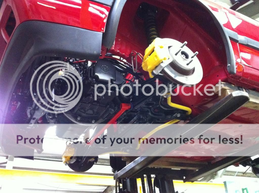

    This is a picture of the underside of my trackday car which ive just finished building already have had one outing at snett, i already have a quaife diff for this box.
    The flywheel has already been lightened to minimum weight before you loose any engine braking and the engine has had alot of head work.

    ^^^ Looks very clean :thumbup:

    Believe it or not, the box you have, even with a light 02a flywheel will still 'feel' quite flat compared to the same engine with an 020 with a lightened flywheel, even if the ratios were the same. Main reason is the weight of flywheel. The 020 would be around 3.2kg, the 02a 5.2kg(bit lighter with a fidanza). It kills the feel regardless of the headwork and shiny paint on the underside of your car lol
