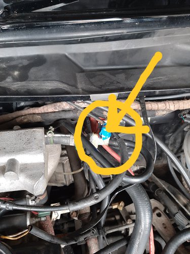

    Can anyone tell me what this part is called? Cant find anywhere that sells anything that looks similar. I know it's linked to brake servo and is some sort of non return valve but if anyone has a part number be much appreciated.
    The tape is covering a small hole which has been caused by the throttle cable rubbing on it. Its stopping the leak but not ideal. 20190903_202003.jpg
    It's a non return valve, or one way valve. Brendon Moss in Dubstock or similar should have them.
    the bit with blue tape is a sealing cap, VW still sell them part number 431 611 817

    Ah great. It's basically crumbling away. Is that part number for the little cap or the complete valve? I assumed it was all one piece as it is so brittle didn't want to mess about with until I'm sure I could get another one!
  6. Tristan
    The cap just the pops on. You could replace it with a bit of blocked up vac line if you were stuck.
