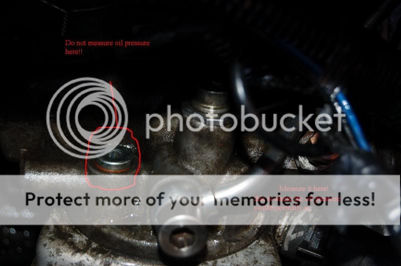

    Found the problem (well gms did) ! Actually no problem with oil pressure...measuring it in the wrong place...this is before the pressure relief valve in the filter housing. I have now tapped it in after...this is where the stock oil pressure switch sits....silly putting it anywhere else really, just assumed that all tappings on the filter housing where the same....
    Thinking this is the place to measure the crank shaft oil pressure...[:s]
    Anyway, i'm happier now! Doesnt explain the smoke tho sadly...possible turbo seals[xx(]
