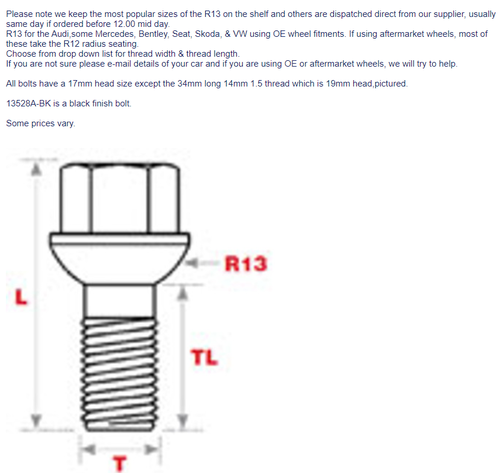

  9. Jon Olds Forum Junkie
    There is an R14 curved fitting too.......
  10. rubjonny
    the 5 stud cars use M14 bolts so its probably referring to that I guess? but yeah, VW wheels = ball/round seat and most aftermarket are taper seat. step 1 is ID what your wheels have, then match the bolts to suit. squidge a big bit of blutak in the bolt hole this will tell you what shape the bolt seats are
