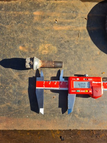

    I've jus been measuring up for wheel studs.
    Fox alloys and 15mm spacers required a 40mm thread length so no spacers would require 25mm thread length.
    The hub is 13mm so 8.7 turns on an M12x1.5 bolt to fully engage threads (10 turns as said above is a good rule of thumb).
