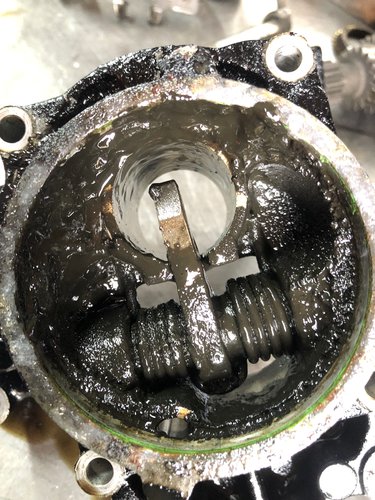

    Thanks guys. Reason for more frequent changes is that I changed my oil about 4000m ago. I’ve just put in a new clutch and drained the same oil at that time and it was black again. Removing the end cap there was crud in there and I just thought an increase in frequency will help flush that all out from elsewhere in the box too. That’s it really. And thanks Johnny that is a v.reasonable price. My dealer has priced it at almost £20/litre. That was G005 000. Dunno what the difference is apart from a tenner a litre?

  8. costel1969
    Holy smoke that's some amount of crud - looks like that's another job added to my "to-do" list
