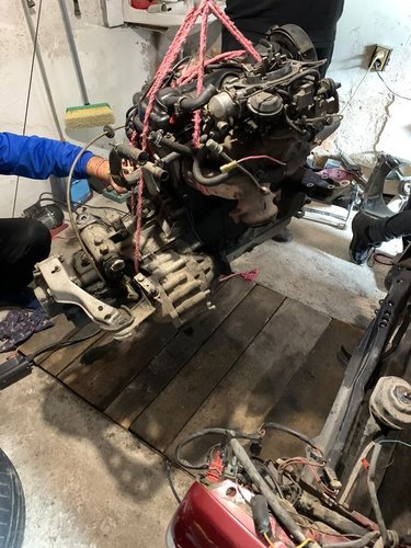

  8. KristianBG Forum Member
    May 24, 2020
    7
  9. Savagesam
    Nice :)
    KristianBG likes this.
  10. KristianBG Forum Member
    May 24, 2020
    7
    The workstation [:D]:o

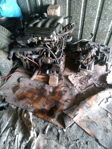

  11. KristianBG Forum Member
    May 24, 2020
    7
    Little update
    1990 likes this.

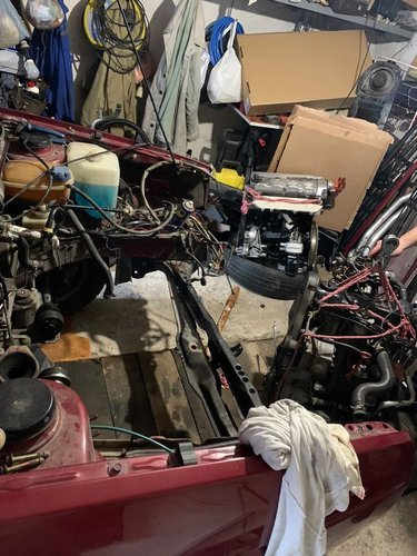

  12. KristianBG Forum Member
    May 24, 2020
    7

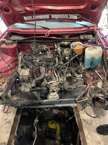

  13. KristianBG Forum Member
    May 24, 2020
    7
    After 6 months of exams , technical university stuff , we are ready to start .:thumbup:[:D]
