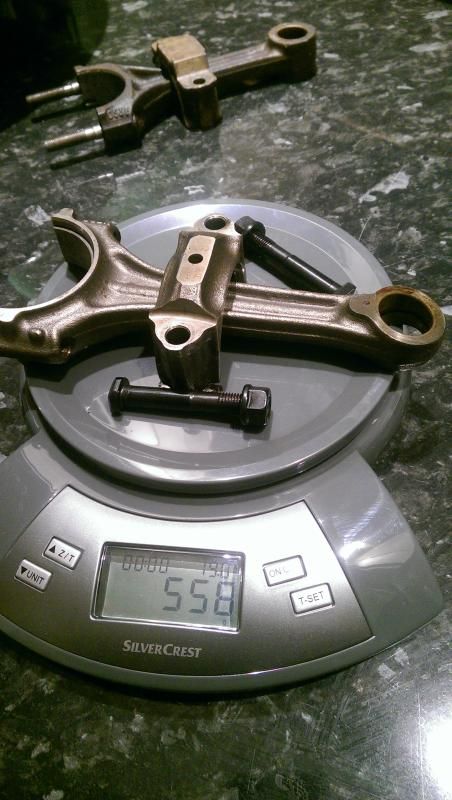

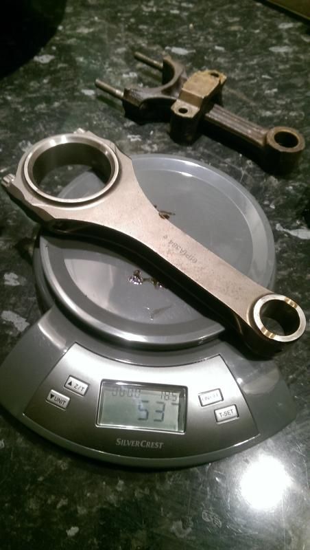

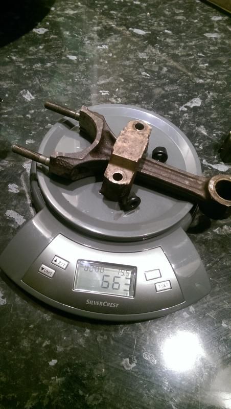

    anyway , pics... comparisons.
    ALT rod , cap and ARP bolts.
    KR/9a rod cap and bolts
    and........... for a comparison , a proper all singing and dancing Pankl rod from an out and out factory race car . Very similar dimensions to the VW rod.
    ALT makes the KR one look heavy!
