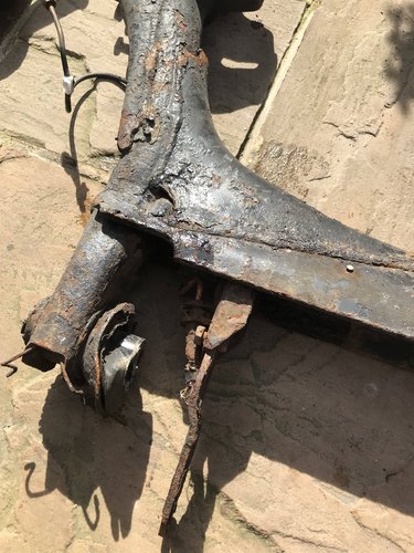

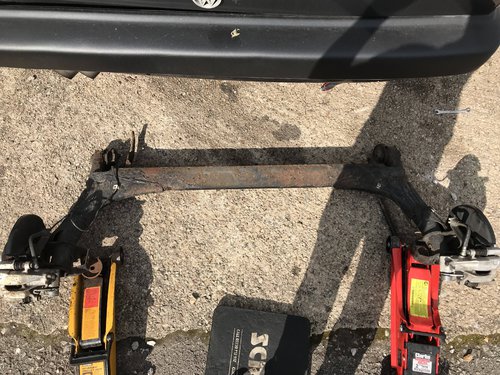

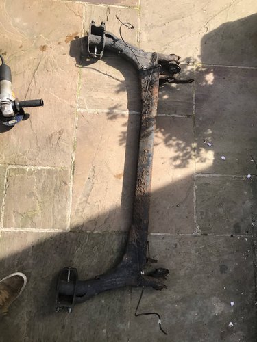

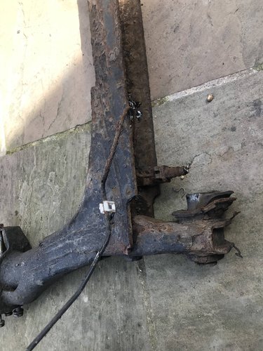

    Rear Suspension
    I've already covered part of this but to recap, fetched the rear beam out last year...
    Original bushes and brake lines. Previous owner has "painted" the beam, fitted new brake dust shields and calipers. They're from BiggRed and one of them is really nice, looks new. The other(I'll add pictures) has been painted with what I can only assume is rust accelerating paint. Its on various parts of the car is terrible.

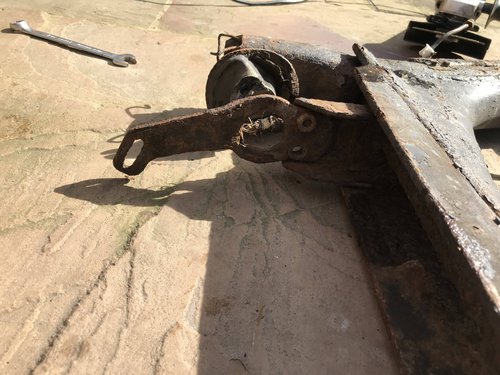

    Some closer shots of the beam, bushes and destroyed brake pipes...
    IMG_2850 - Copy.jpg IMG_2846 - Copy.jpg IMG_2851 - Copy.jpg IMG_2847 - Copy.jpg

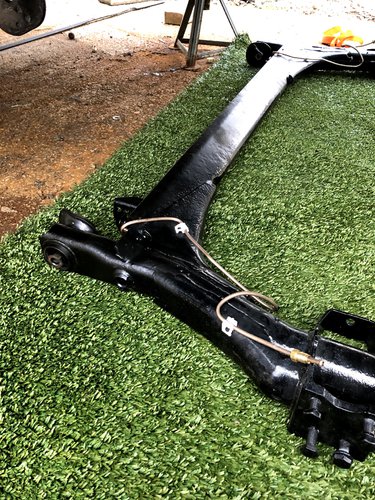

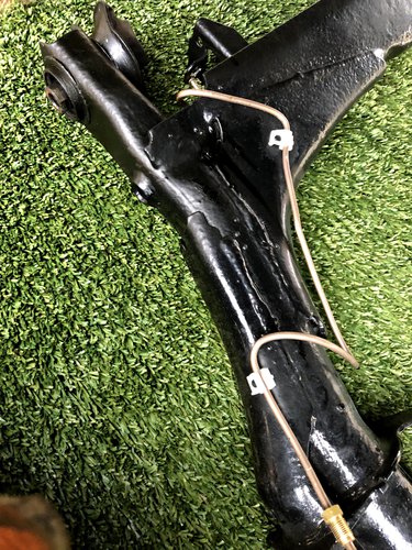

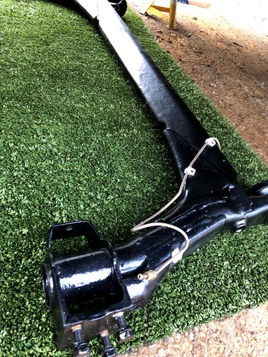

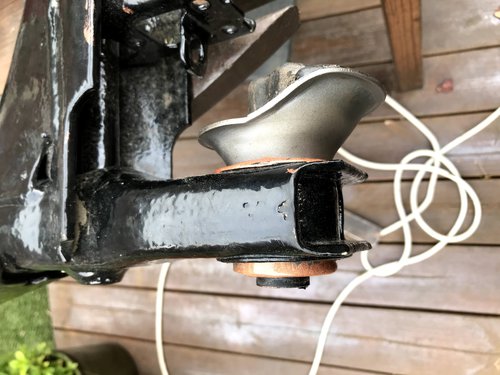

    The beam, cross member and rad support where sent to a local coating company who blasted with garnet to SA 2.5, Zinc thermal sprayed, epoxy sealed and then coated with two coats of polyurethane gloss @ 50µm. This is the same coating process used for bridges and oil rigs, albeit with far less coats. In its current form its rated for 20 years before failure, so a little bit better than the wisp of black paint VW apply[:D]
    The result..
    In these pictures you can also see the new copper nickel brake lines that run in factory routing (anyone know what the big pointless looking bend is for?) and new lemforder bushes. Only thing missing from the brake pipes is the factory green look like @GG. achieved The brake pipe clips are OEM and sourced from Mecatechnic in France. The whole beam has also had a coat of Dynax UB with Dynax S50 sprayed into the ARB. A new Borgeshung bush was also fitted to the ARB.

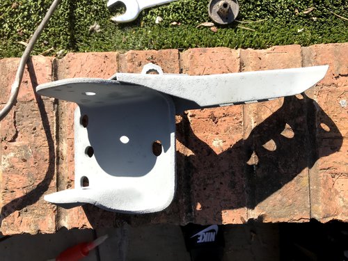

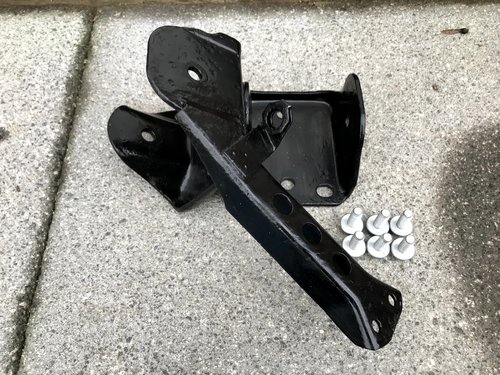

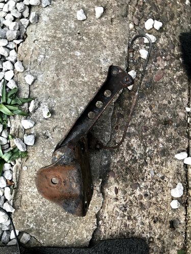

    Next was the beam mounts which looked like this...
    A Deox-C bath and some wire brush action later
    There were sprayed with 2 coats of Electrox primer and then enamel paint. I would have had these done with the beam but I didn't think ahead. It will be a good comparison of the coatings :)
    The finished article with new Geomet coated 10.9 bolts.
    I'm using XCP rust blocker on all fasteners a torquing lubricant and additional rust inhibitor

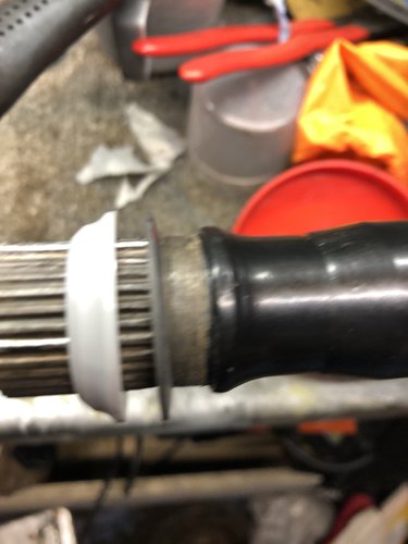

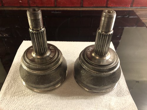

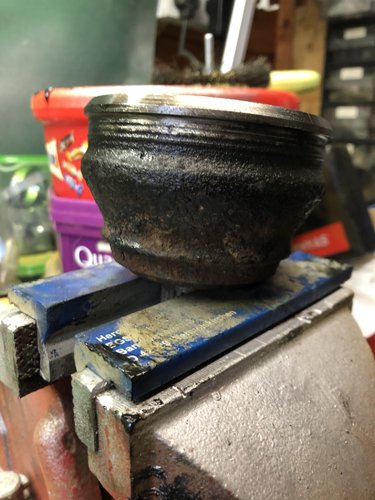

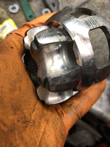

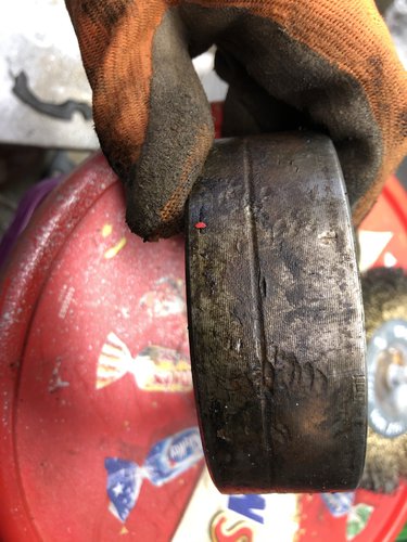

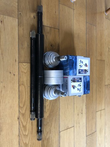

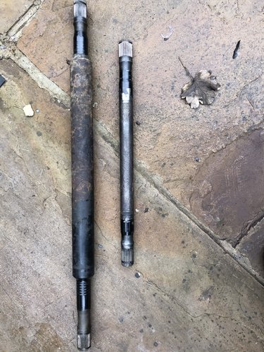

    Back to the front axle, the original drive shafts were very grotty, started wire wheeling, thought sod that and got them blasted and powder coated instead

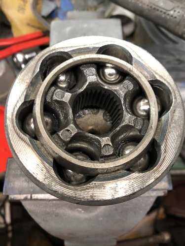

    The CV's both inner and outer were fine, no discolouration and just some polishing which you couldn't feel, so I decided to clean them up
    Someone has clearly got very angry with this inner CV, many times [:D]
    They were then painted with Electrox and silver top coat, the original inner boots were actually in great condition, but the outer ones were shot so new GKN boots were in order. Re-assembling outer CV
    I don't have a picture of the full shaft, but I'll get some of them on the car!

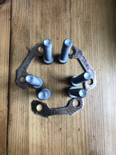

    Also have brand new bolts and re-plated spreader plates to go along with them
    erreesse, davkav and Vinnie like this.

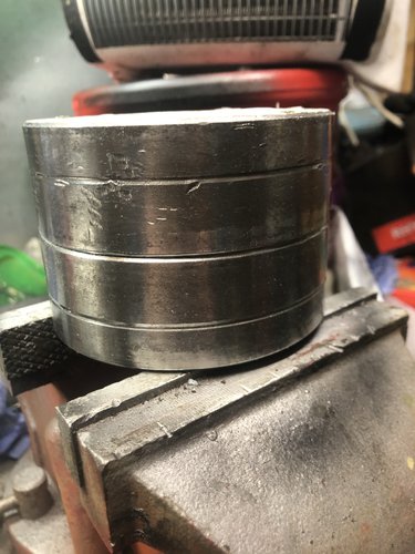

    You also need a set of bump stops and for this a Febi stop and cover was chosen. After much deliberation I decided to go against the TUV approval and cut my bump stops. I chose to do this mainly because I wanted a slightly softer ride. These aren't really bump stops in the classic sense, they're "Jounce Bumpers" which are actually designed to act as springs when the car is heavily loaded or under high compression. The ways I've seen of cutting these before is a bit hacky so I decided to take a neater approach
    Bump stop choppin' how to
    I wasn't sure how much to shorten my bump stops by, initially I chose around 20 mm (the middle section) which is where these pictures are from. I then re-did it for the final ones at only around 15mm (bottom section) you could remove both if you wanted them really short, or even add more sections with this method. Anyway, first cut the bump stop, hacksaw works well for this:
    I've discarded the middle section here, you should try and get the cuts as neat at possible but if its not perfect then thats okay! Give the surfaces a quick clean and wet one of them with tap water. To the dry surface, apply Gorilla glue, just enough so it squeezes out, get them as even as possible and clamp them up. Not crazy, just enough so they're held nice and straight.
    You can keep wiping off the excess for the first 30 mins with a wet cloth, and then just leave it for 24 hours to fully cure, giving you the finished product:
    This works so well because orange Gorilla glue forms a Polyurethane foam, the same material as the bump stop. It also lets you retain the bottom mount for the dust cover and the necked down area at the top to hold the stop in place on the piston. The bond is very strong as I didn't break or damage the joint at all when installing the dust boot, which anyone who's done it will know requires substantial force.
