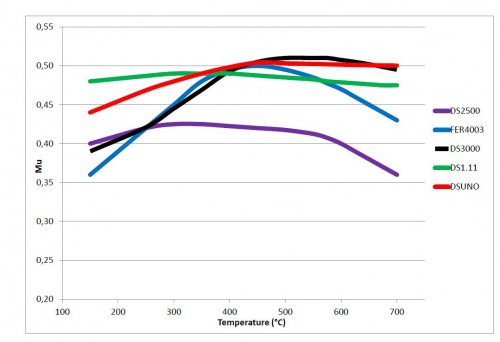

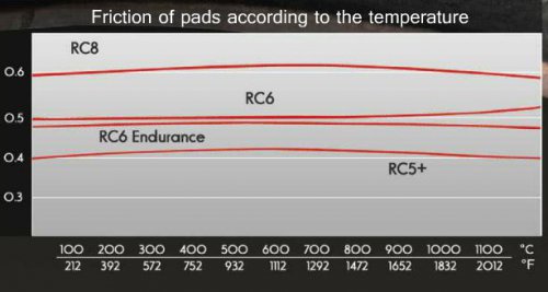

  19. Toyotec
    Just looked at the friction performance between the CL RC6 and the Ferodo DSUNO. I might just try the DSUNOs next.
    Henry fitted the DSUNOs to his fast french thing and on the recent Bedford trackday. He was punishing the stock brakes with very late stabs into bends and they were happy with minimal dust.
    Cold working friction exceeds the older DS3000 'race' compounds and remains just as stable when hot. Plus they are kinder to disks.
    In fact I would say, based on those mu plots, maybe this type of pad may even be the best compromise for a part road, part track car.
    CL Pad mu plots also listed for comparison.
    :thumbup:
    Mjj4 likes this.
  20. MUSHY 16V
    Jan 26, 2008
    803
    aberdeen
    This one shows it a bit better [​IMG]
    Mjj4 likes this.
