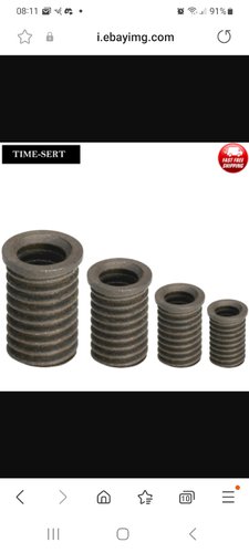

  5. KeithMac Forum Junkie
    215
    Kazakhstan
    I personally prefer the Wurth Timeserts.
    The kit is not cheap though (drill, countersink, tap and fitting tool).
    AllanWorms likes this.
