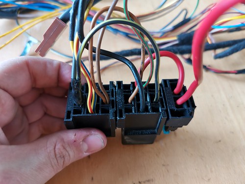

    Been doing some bits but forgot to take many photos.
    Fusebox to engine loom extended just to make it all much easier to route internally.
    Engine loom looks much tidier now

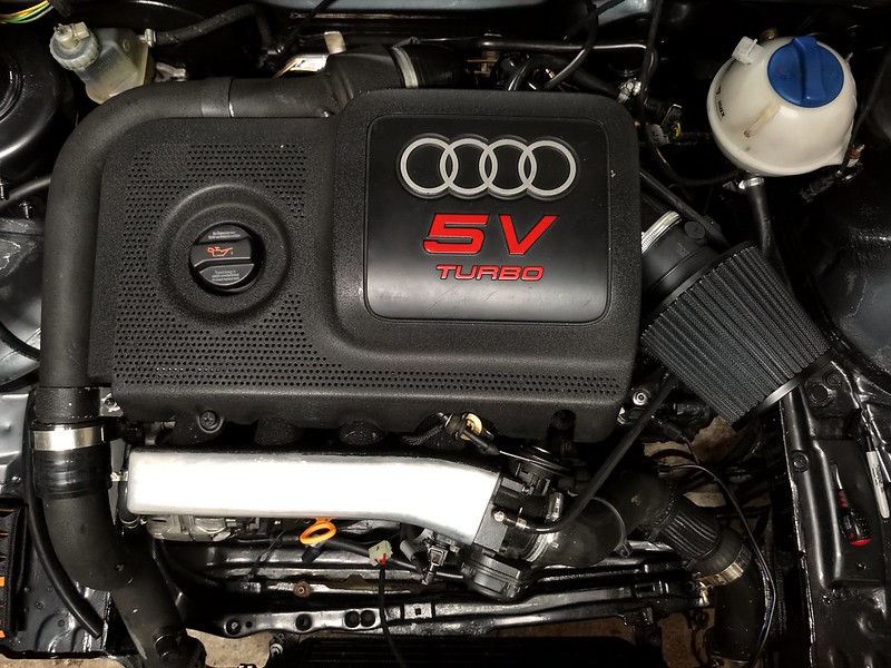

    Modified the TIP, MAF and intake
