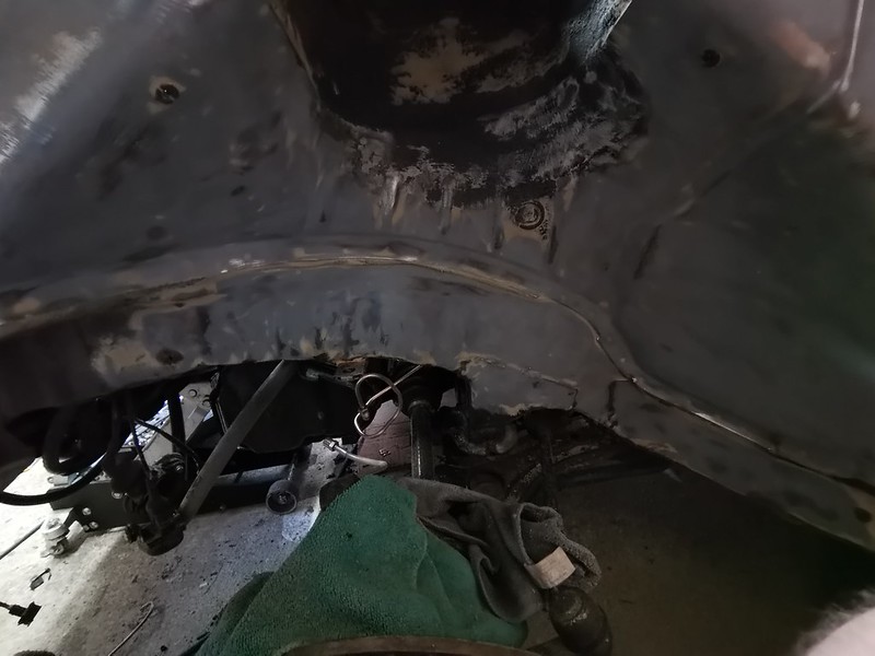

    South West

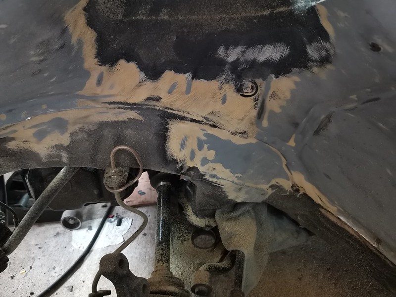

    N/S arch looks decent after its strip down.
    the turret was painted when it had some welding done at the time of the engine bay refresh..so i'll give that a key and paint over it with the Raptor.
    I'll give it a spash ok hammerite Krust to convert the one tiny bit thats a bit brown (about the size of a 5p coin) and the rest will have that coating too then. Prime then paint.

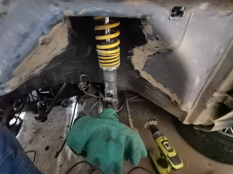

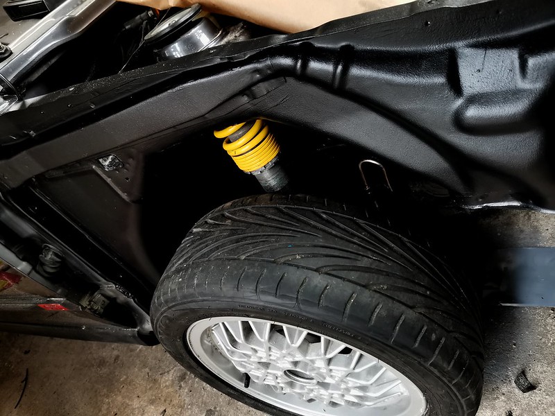

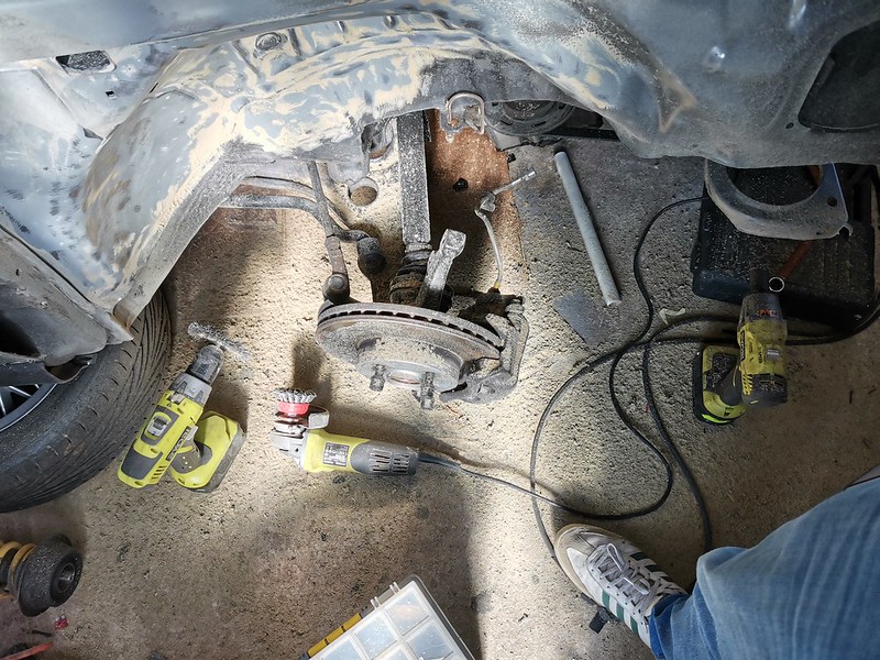

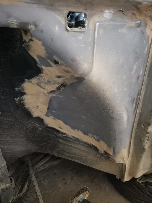

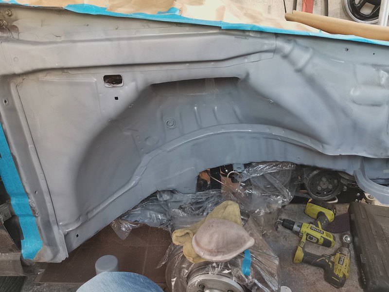

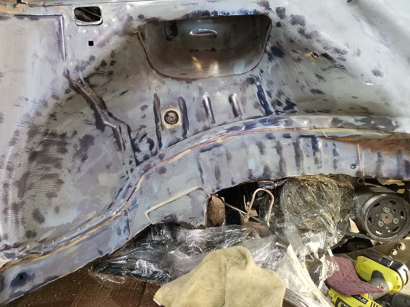

    bif of a day today.
    Started the day finding a parasitic draw on my wifes Transit Tourneo, fixed that then replaced the battery as the main one was FUBAR from weeks of being flat.
    finished stripping the n/s arch then did the o/s arch.
    Both treated with rust preventing metal treatment and then a few hours later they were both etch primed.
    Tomorrows plan is to mix up the raptor and roll that on in 3 layers using a smoth foam roller. This will give a nice light dimple finish which will be easy to clean and not give crud much to stick to.
    once thats done i'll apply some black schutz to key areas.

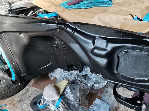

    Back in Black. this was after the first coat.. I have added a second and think this will probably be enough. i've also gone up over on the lip of the inner wing as the outer wing sits on that and it could be an area prone to damage when fitting the wing.. so a bit of protection there.
