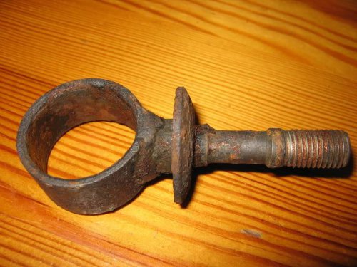

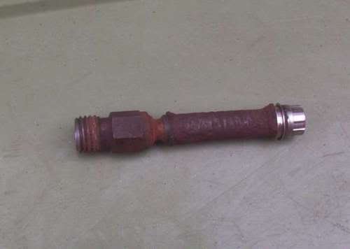

    This is a very rusty I-Link, it's been on my car from new and I was going to throw it out.

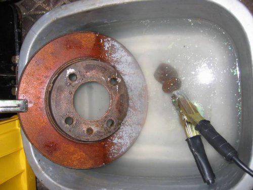

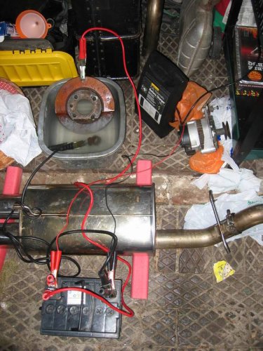

    Here is the 'cell' (created from anything plastic; Ice cream carton, bucket, washing up bowl etc) with the water/saline solution, a battery charger, an Anode (a lump of iron - old disc brake in this case) and the cathode (The I-link i want to remove the rust from.)
    The saline solution is made from adding one tablespoon of washing soda (Arm & Hammer, baking soda for example) to 4 Litres of tap water - that simple. I used this as i didn't have anything else, but, it work really well.
    As I said the Anode needs to be a lump of iron preferably, bigger the better, this is then connected to the RED POSITIVE terminal. And the Cathode is the metal to be rust treated, this is then connected to the BLACK NEGATIVE terminal. Switch the battery charger on and (As long as you have good connections - my need to scrape some rust off) you will see small bubbles rising from the Cathode. [:D]

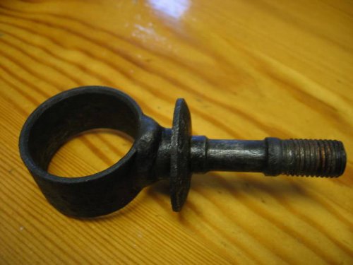

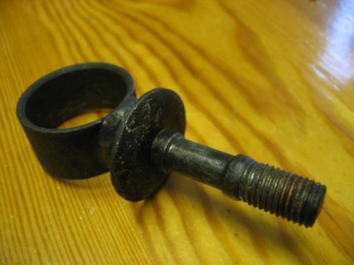

    After a few hours I took the I-link out and scrubbed it under running water, it looked like this.
    After a few more hours I removed it again and it was rust free! [:D] Note the oxidation that occurs turns the metal black.

    NOTE; In my picture I'm using a battery as well as the battery charger, this is because the battery charger will not pass current until there is enough resistance (It's a safety feature) So to get around this I connected it to a battery (As that will give the correct resistance) and then used jump leads to connected the battery and charger to the 'cell'.

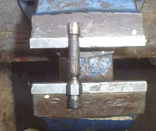

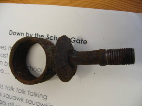

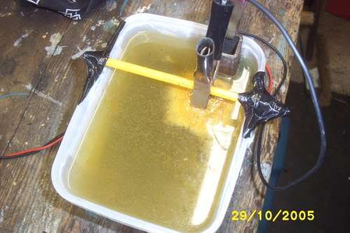

    Good work :thumbup: the thread you linked too, the pictures no longer work but I still have them.
    Before
    During
    After

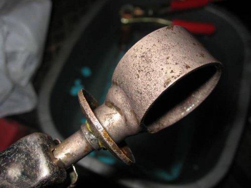

    Ha ha, here are the update pics I said i would post.

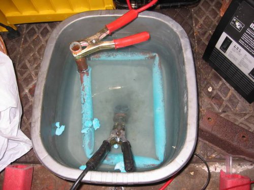

    This shows how I have bent the copper Anode around the 'cell' to produce better and quicker effects. The process works via line of sight.
    Here's the I-Link so far, it's not complete but it is on it's way to being plated.
